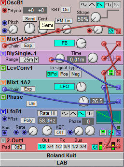

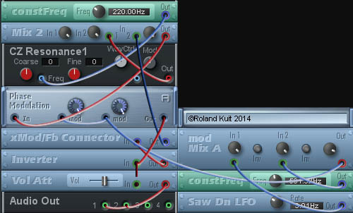

I can do that for you.
I just wasn't sitting behind the Xite(yes, I have it still here).
This was done with the Clavia NMG2Demo on my tablet in the train.
You can find this here:
http://www.clavia.se/products/nordmodular/demo.htm
As I told Holger, it would be a great tool to make something like this(Demo) for the modular Scope versions.
Than you can work any time and everywhere.
As a start, all was developed in a pc and Demo shell.
I would keep the Xite-1 when such a tool was there.
Tweak the the modules on the right.
Phase Freq.rar
(543.86 KiB) Downloaded 218 times
http://www.rolandkuit.com/
