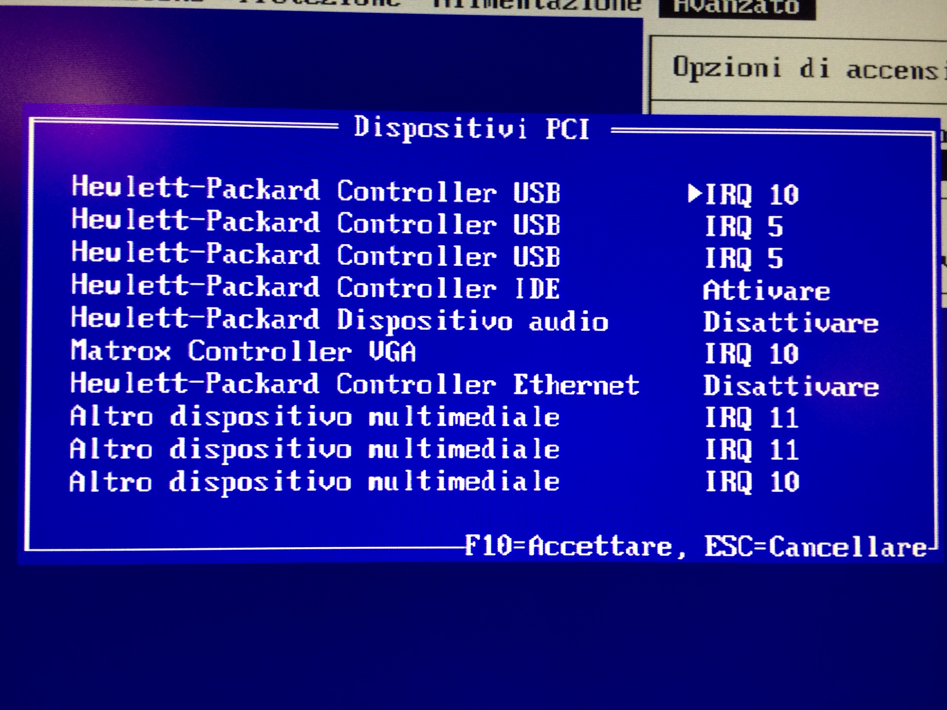

So I've checked my IRQ configuration (see attached photo).
"Altro dispositivo multimediale" means "Other multimedia device" that is "Pulsar2".
I could disable one of the usb controllers (actually irq10) but I need at least one usb.
I am forced to share the graphics card with one of the Pulsar2...
The available IRQs are: 5,10,11 only these.
What would you do? :(
