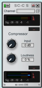

				This is the stock SC-C S compressor that comes stock with Scope 5.x
- SC-C S
- SC-C S.jpg (18.76 KiB) Viewed 25312 times
Now when I tried it out, the Loudness seemed to just boost the volume same as turning the input up.  And there are no more controls.
For ScopeRise, does anyone know what this would be usefull for (eg low DSP scenarios?), and given there's no usual ratio / threshold controls, would that imply that the 'Loudness' is somehow a combination of ratio / threshold ?

				It performs the basic function of the compressor. Lowers high levels, boost the low levels so to reduce the dynamic range. The input is the ratio and the loudness the boost. (i haven't used it but propably i'm right). It is not for low dsp scenarios. It is for setups that you want that type of standard compression.
If you often use a compressor you understand that after a while you always put the threshold at a certain height and then you just raise the gain 6dB so to compensate for the reduced peaks, and that way the signal gets compressed dynamically. So the next logical step is to omit alltogether the threshold pot, omit the ratio, and get a input gain instead that will act as the threshold/ratio. The loudness is the gain at the end of the chain.

				the harder the input signal hits, the more compression. the loudness control is for makeup gain, so the the peaks remain the same.
it's a basic compressor similar to many dBx units or an LA2.

				This is great stuff guys and I intend to distill it into scoperise article, but I am looking to sum up in a single sentence or maybe 2 or 3, how this compressor works, with less controls than most of the others many would be used to.
So, from a beginners point of view, would the following sum it up about the controls on this compressor :
"This is a basic compressor where the 'Input' control serves a similar function to 'Ratio and Threshold' on other Scope compressors, and 'Loudness' would be similar to 'Make Up Gain'."
