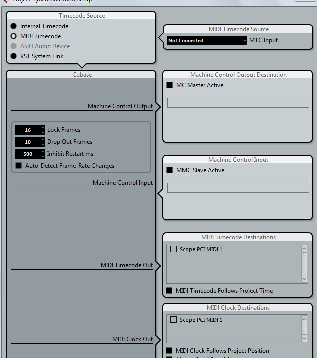

Try changing Timecode Source > MIDI Timecode to Internal Timecode. Maybe that what you mean but it is hard to understand what you want. But I hope that helps.

t_tangent wrote:Try changing Timecode Source > MIDI Timecode to Internal Timecode. Maybe that what you mean but it is hard to understand what you want. But I hope that helps.
It is obligatory for MIDI Device to create? Because without it mistiming. Internal Timecode should be adjusted or to leave by default?

what do you need midi timecode for?
for kick me and minimax it's not needed.
For other tools such as arpeg02, you only need midi clock and there isn't a timecode option, so better you don't send timecode where it is not required.
You don't need to add scope devices as external instruments, it's enough to control them over midi ports from the sequencer.

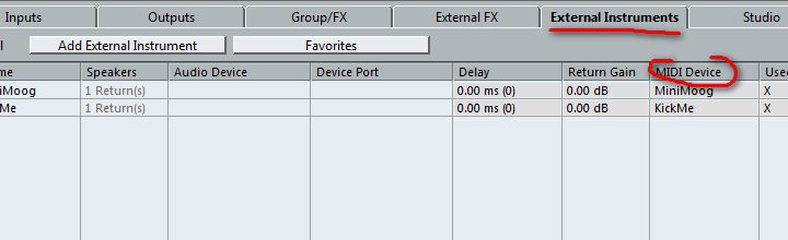

Without MIDI Device at tools mistiming. Shift to the right

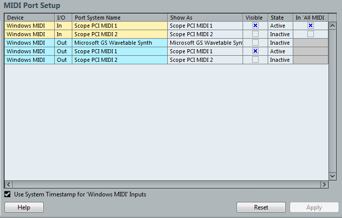

Re: Synth drift
did you check "use system timestamp" in the midi menu in Cubase?

Re: Synth drift
i never use external instruments settings and i use midi in Cubase from Scope all the time.
Re: Synth drift
Yeah scope can do that routing no need to do it in Cubase

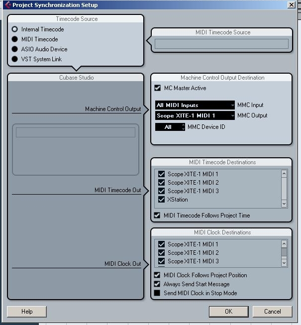

Here's how my Project Sync Set-up window looks. Also, do not use External Instruments.

Mr Arkadin wrote:Here's how my Project Sync Set-up window looks. Also, do not use External Instruments.
If not External Instruments.. how? I want to use a mixer Cubase. thank you

Personally I never use Cubase's mixer. I route via ASIO from Cubase into a Scope mixer. You can plug all your Scope synths and effects into the Scope mixer. You can then feed the result back into Cubase for recording. There is no latency this way.
