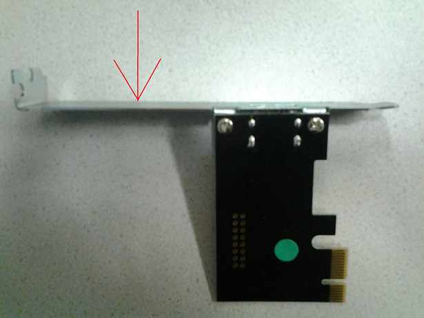

anyone know where to get a smaller metal plate for the xite pci card?
see my probl. -->
metal plate
metal plate
- 2013-12-13 10.16.01_b.png (5.66 MiB) Viewed 3007 times

I wish I knew what chassis you were using so I could see more, but there are 1U Chassis that are fairly cheap with built in Horizontal slots.
You are looking for a HH adapter maybe like this.
HH means half height, usually followed bu a HL or FL, meaning half length, or like GFX cards Full Length.
Our cards are actually FH-HL, meaning full height, half length.
http://www.ebay.com/itm/half-height-bra ... 4acd5a3fcd
My next upgrade includes a mATX Supermicro 1150 board and chassis.
It has an mSATA connector so I can have a tiny mSATA OS+Apps device on the board itself, with 2 x Horizontal PCI slots. One for the S|C Connector card (FH-HL), and one for the PCIe SSD for sample streaming. A chassis like that would be nice if you can't use the above adapter.
Cheerz
Cheerz

Maybe there is a workshop around who can modify your current metal plate to fit? The thing about getting another plate is, that you still need the HDMI slot.

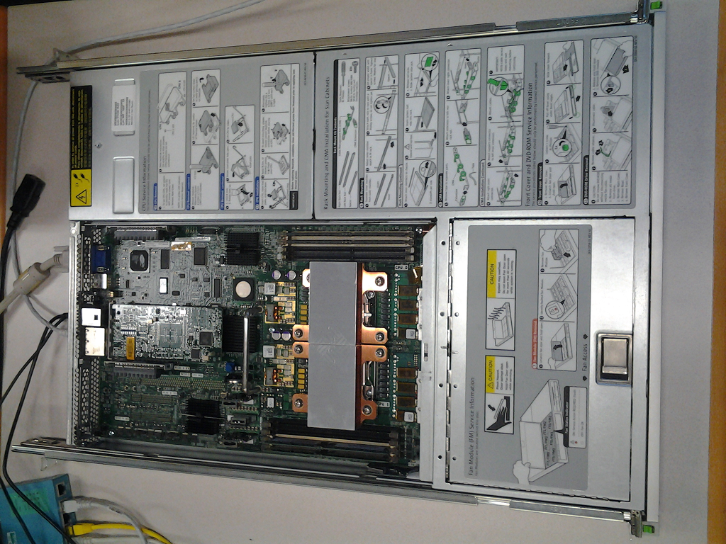

have a new toy_
sunfire vibes
sunfire vibes
- 2013-12-13 15.28.45_b.png (1.64 MiB) Viewed 2973 times

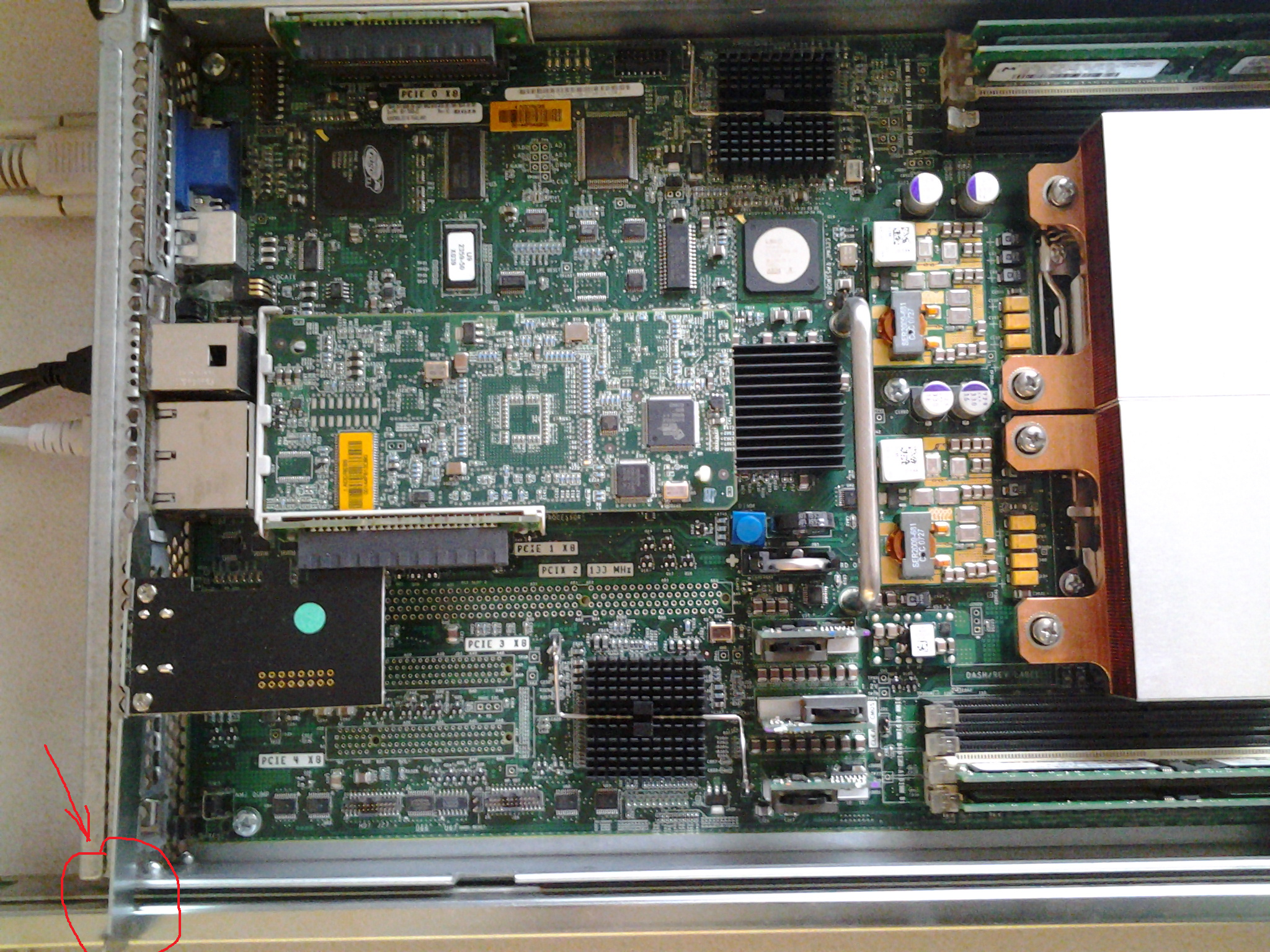

the metal plate on the pcicard is too long;
i screw them up . . but then the card just holds with its connection to the pcislot
a little bit stabilized with the cable;
o.k. for testing but i need a smaller metal plate to put on the card
- 2013-12-13 10.35.33_.png (520.78 KiB) Viewed 2972 times

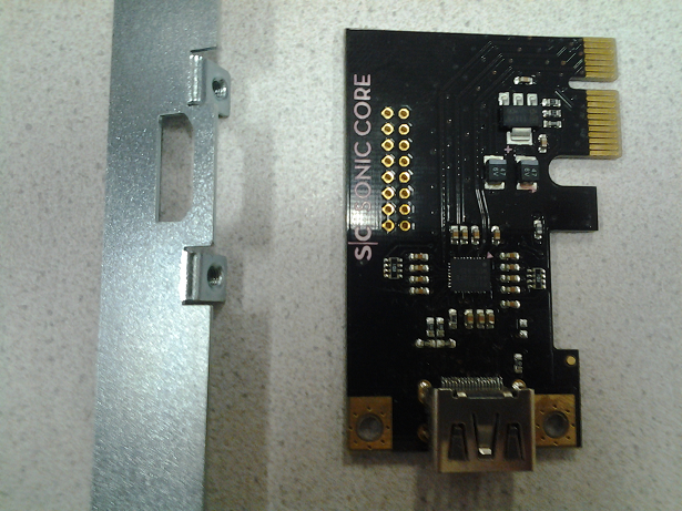

Yes, but one challenge is, that you do not just need a low profile plate. You need a low profile plate with a HDMI port - and the screw holes for the card in the exact same relative places. That is the reason I recommend a smith who will bend your plate, make the whole for the chassis mount and cut the excessive part of. Or you could do it yourself. Maybe you can ask Sonic Core to provide you with a plate without card - and then butcher that plate, so you still have one in normal length. I imagine it will be hard to find a standard low profile plate which will fit with your Xite card.

the connector is not connected with the plate itself;
there is just a hohle in the plate;
thought there is a standart for hdmiout-plate-small
yes cutting the plate is a way;
i would prefer srewing to another plate you know

i think you just need to remake the bracket. cut, snip, maybe solder/braze done....
