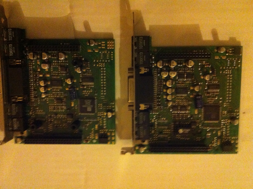

Re: pulsar2 Classic or Plus?
Posted: Wed Jan 29, 2014 7:10 am
by Tau
Classic I/O - Plus I/O
IMG_0282 copy.jpg (354.07 KiB) Viewed 4560 times
Here's a picture of a Classic I/O (left) and a Plus I/O (right). Two extra caps on the Plus.
Posted: Wed Jan 29, 2014 7:32 am
by igge1
And a voltage/current regulator too, from what it looks like.
Posted: Wed Jan 29, 2014 10:18 am
by jhulk
i would say its a balancing ic as it has balanced i/o plus the extra dc blocking caps
Posted: Wed Jan 29, 2014 10:59 am
yep, you can see the extra ic on the corner and another towards the middle. the one towards the middle has an extra cap.
