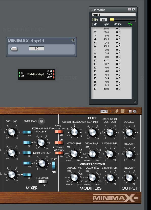

I'm converting some devices to be loaded straight on specific dsp.
The list will grow as i convert them.
Here the download page:
http://goo.gl/x4qeAQ
The use is simple, the modules have the dsp number on the name, and synthesizers have also a fixed polyphony set on the module.
Once the module is loaded, open up the surface and push the button to open the main device surface as devices are protected and the only way i have found to open the original surface is to use midi cc sent by the button of course.
The default cc for opening surface is 116, but you can change it.

I just dl'd them and loading them into the XITE-1 now.
This is similar to Modular now.
I'll see if this allows larger projects.
Thanks So much for your time...

Works great. Recall prooves they remember the assignments.
Well Done Boss...

Re: DSP Optimized devices
I think you are right Dante,
the xite-1D is 10 dsp, but i have not found in deep details about the dsp's.
Is it like the xite-1, where the first 6 dsp are older sharc for I/O operations, or is it different?
If so, i could add devices optimized for dsp 7 to 10.
yes the DSP 7 - 10 are the 21369 same as on full XITE with the first 6 being the older DSP for compatibility and IO etc also the same as on full XITE.djmicron wrote:I think you are right Dante,

The DSP on full XITE are arranged in 4 slots. Can't remember whether the D has 1 slot of 4 or 4 slots of 1 - Ralf once told me but I forgot. Anyway this smaller design lead to simpler architecture for coding purposes, but may also make the gains of manual DSP assignment redundant or minimal. No idea but of course it's open to experimentation.
- Posts: 1638
I think it's four slots of 1, so that means 6 "old" dsps also.
						- Bud Weiser
- Posts: 2930
- Location: nowhere land
My guess is, it´s 4 slots of one,- so generally same architecture as XITE-1 and the same mainboard in use.dante wrote: The DSP on full XITE are arranged in 4 slots. Can't remember whether the D has 1 slot of 4 or 4 slots of 1 - Ralf once told me but I forgot.
Less SAT connection errors because DSPs #3-#6 have only to communicate w/ ONE (1) of the new SHARCs,- not 3.
Higher load (%) possible for the time being.
