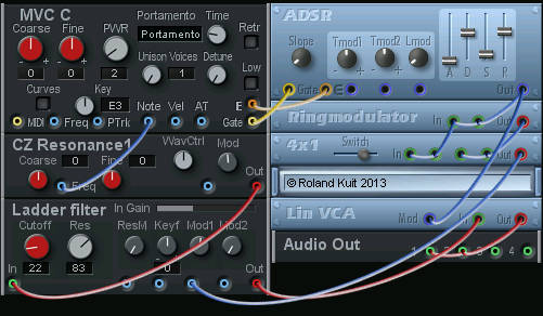

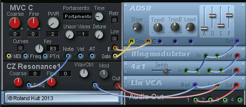

I was reading the specs of JB's Solaris.
When I read his EG-punch trick I remembered I patched this kind of thing years ago with the NMG2.
So now for the Modulars here:
1st: you can choose between the EG and EG-RM modulation of the VCA.
2nd: audio to EG-VCA, here you can choose between the EG-Punched EG/RM filter modulation.
