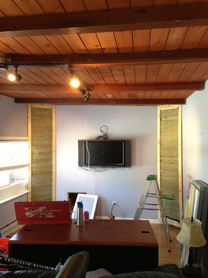

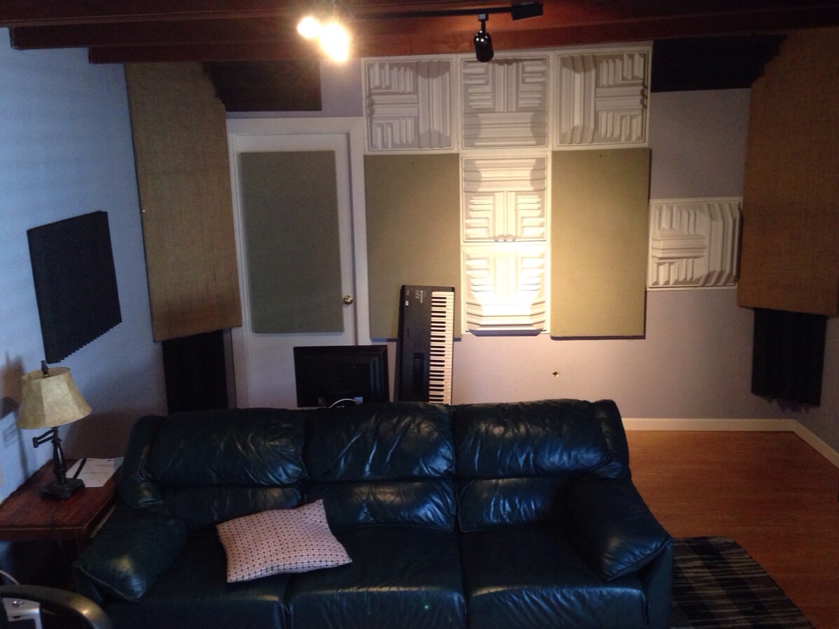

Hi
I am treating my studio to improve its sound see photos. I picked up a load of matrial from a studio that was going out of business 10 703 rigid fiberglass panels a load of auralex foam panels,bass traps and 6 T'Fuser diffusers http://www.auralex.com/sound_diffusor_t ... tfusor.asp I also bought Roxul mineral wool and have built two super chunk bass traps for the front of the studio
My questions is should I use the T'Fuser in the celling gaps between the wood beams this seems like it could be a problem area? Or use them on the back wall. I plan to fill them filled with left over mineral not to sure we're should I place the diffusers?
The room is 9ft by 24ft insulated drywall walls exsposed 8ft wood celling and wood floor

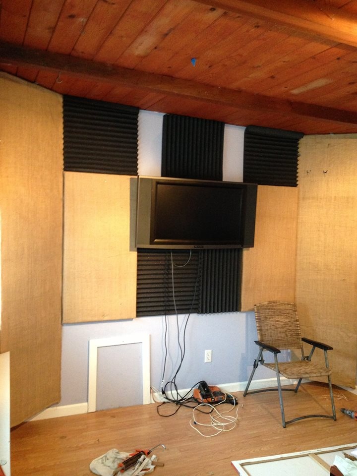

diffusers belong at your side, to your back, and if more are left over, in front. above you might be nice, but it's last. you can make them too....
if you can, your mix position should be near the middle of the room.

a few tips:
mix position: at around 38% from the front and centered for the width of the room
speakers: shouldn't be in the middle (floor to ceiling)
first (early) reflexions: get a mate to hold a mirror at the walls/ceiling while you're sitting on the mixing position. the position of the mirror on which you can see the speakers are the early or first reflexion points. These should be treated first... so yes, the ceiling should be treated in my opinion... (http://www.youtube.com/watch?v=B9u7k2V4YPw)

The roof is never as important as your back, spend much of your material for your back wall to have clear bass response and this will give you lots of space to receive the rest of the frequencies with more separation.

Nestor
just figured this out ! I was at the back of the studio and there is a lot of bass back there! was going to skimp on the back of the studio and use foam bass traps but will now build two superchunk traps like the front :)

Try to put it exactly behind your hearing area, building sort of a square behind you.
The following picture is not exactly that, but it will give you a clear idea of what I mean, except that the square should be behind you, not at your front or side, and it should also be "much" thicker than the two rectangles you can see here:

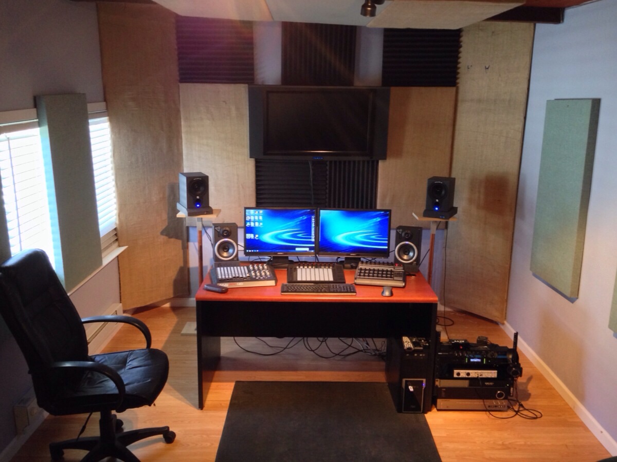

So nearly finished it sounds great bass is good and stero field much better !
