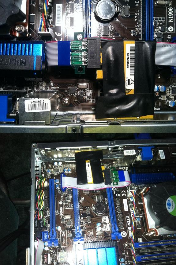

I should have done that but it's in the 1U and racked up now.
I do have a jpeg. of the ribbon extender I use and when it was hooked up to the PCI-e 1X slot below.
This shot only prooves how stable the XITE-1 works using the extender and a 1U, and also over a year now of gigs w/o using a GFX card.
The GPU of the Ivy Bridge is more than powerful enough to handle DAWs and Scope together, and I am only using 128MBs of the RAM.
256MBs being the maximum option in the BIOS of the MSI Z77A GD65.
I love Duct Tape as you can tell, and used another piece of thermal 3M Tape to cover the 16X exposed pin connectors.
Next time I blow out the 1U Chassis, I'll remember to take some shots of the PCI-e 3.0 slot all connected.

Re: PCI-e 3.0 16x Slot
So you have taken the XITE-1s PCI-e hostage with duck tape
Looks good and inventive.
i think that tape is insulation to avoid shorts.

Well I finally had my first crash during a gig, and it turns out the direct connection to the CPU using the 16X PCI-e 3.0 protocol wasn't such a great idea.
It worked for hours here and while I knew that tranfer rates, and bandwidth wouldn't increase, I was willing to try the .01 msec. latency that PCI Express offers.
This might be a bad idea afterall.
But it was fun being able to stomp on my A/B Switcher and use the weak sounds of the Privia.
The Hammond cheese on the Casio was sheer torture.
Any ways don't try this...

Re: Don't Try____ The PCI-e 3.0 16x Slot
i think the biggest problem is the small connector in the big slot. it can make a sloppy connection.
when you're in a 16x slot with a 1x card, it's a 1x slot.
