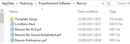

Okay found solution here:
https://www.propellerheads.se/forum/sho ... p?p=975418
From the readme:
Reason 6.02
Optional workarounds for ASIO driver bugs on Windows
Reason 6.02 ships with two optional workarounds for known bugs in a few ASIO drivers.
Some of these ASIO drivers fail, hang or crash when queried through the runtime-system (Microsoft COM).
For such drivers we have a workaround making Reason avoid such queries.
This workaround is called ìNo ACEî and also disables detection of special features in the Balance audio interface.
Others simply fail, hang or crash when started ñ these are usually secondary ASIO drivers that are not in use, and
sometimes even when the hardware is not connected. For such drivers we have a workaround making Reason
only touch the user-selected ASIO driver and no others. That workaround is called ìNo Sound AutoDetectî and
also disables auto-selection of audio drivers and fall-back when the active audio driver is stopped or the current
interface disconnected.
List of interfaces known to have this type of bug in latest ASIO driver at the time of writing:
1. Creamware / Sonic Core Scope-series
2. AudioTrak Maya 44
3. ESI Juli@
Note: Some older versions of Mbox drivers, installed with various versions of ProTools, need the workaround too.
Note: If you use another ASIO-driver, but Reason 6 hangs/crashes as is starting, it doesn't hurt to try these workarounds.
Instructions:
1. Unzip the archive and navigate to the extracted files
2. To turn on a workaround, double-click a "Workaround" .bat-file, then restart Reason 6.02
3. To turn a workaround off again, double-click a "Off" .bat-file, then restart Reason 6.02
Note: While we are not aware of any ASIO driver that requires both workarounds turned on, it is possible if your
main ASIO driver requires the No ACE workaround and another installed ASIO driver crashes on AutoDetect.
Note: It is ok to run the .bat-files multiple times, they do the same thing each time.
I Ran the 'No ACE' bat file and now all is good. Very odd as didn't have this issue under xp with reason 6.52 but did with win7. Reason 7 is also loading up no probs now.

Yes, same problem I encountered but with Reason 7 in Windows 8 x64 and documented here :
http://www.xited.org/viewtopic.php?f=32&t=1043
reason fix
reason fix
