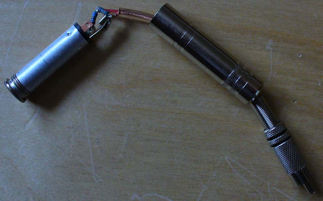

It looks like this:

those should work.
you do realize that the Luna 1/4" jacks are stereo, right? if so, i apologize for pointing out the obvious. :)

I'm using the break out box Luna 2496 io. So mono-klinke to mono cinch. 2 resistors as described above.
It's the other way round: cinch goes to Luna 2496io, 6,3 Klinke Buchse goes to mic-preamp (using Pr8e asym or Tascam MA 8 which is not symmetrical anyway). I'm using the Stereo Input because they were cheaper than mono :-).

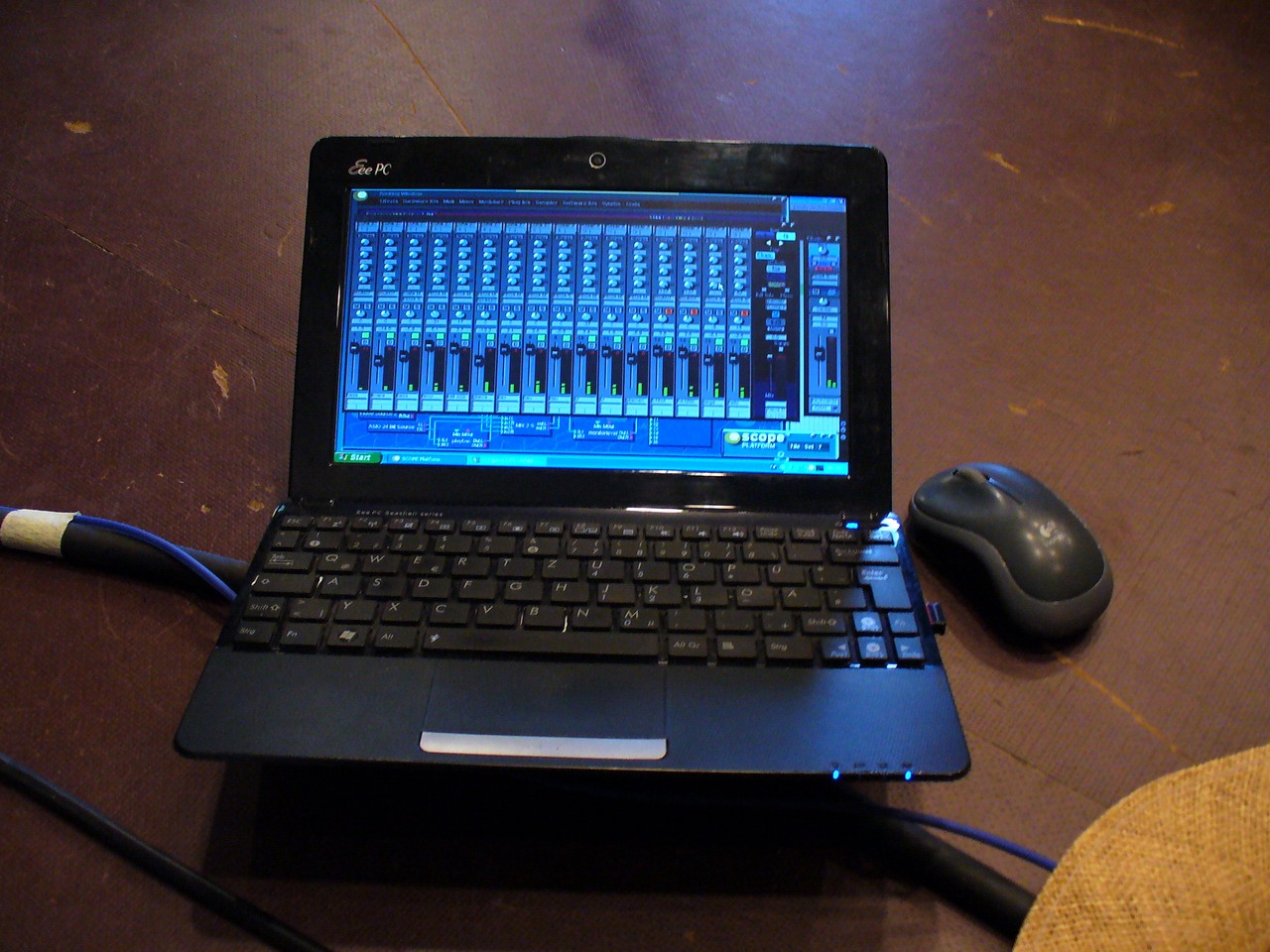

Today tested old Scope-Computer with 11 dsps for Mixing my Music class with 18 channels (15 microphones & 1 bass DI & 2 mono Keyboards). It works FANTASTIC!!! I used my eeepc via VNC with network cable to stand in the middle of the big hall and remote control the scope computer to mix the whole thing.
Tomorrow is the concert & I'm looking forward hearing a great sounding system with my great playing music class.
SCOPE4LIVE!!! :-)
MCCY
Posts: 1208
Re: Using luna 2496 io with hotter input signals than -10dbv
Post by MCCY »
scope on eee PC :-) (via VNC)
Thats pretty cool, remote controlling Scope PCI from laptop. You got any more pictures for Scoperise ?
eg of the PC racked with the Luna I/O box and the concert hall with performing musicians and cheering fans ?

What is VNC ? how is it possible to control with a laptop ? :o
Sonic Core Luna II + Pulsar II scope v5.1.2709-x64, Cubase 9.0.20 (64), Pro Tools 12.7, Wavelab element 9 (64), windows 8.1 pro (64), Asus P6T 18Go RAM core i7 920, SSL Duende Native - Lexicon PCM Reverb Bundle - Waves - Sonnox
VNC is just a remote control PC app where the laptop takes over the screen and mouse of the PC.
So the Scope mixer seen on the laptop is actually running on the PC.
http://www.realvnc.com/
you can use remote desktop, which is built into windows, too.
