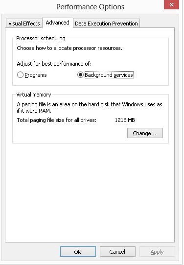

Did you set the audio priority to background process (rather than applications) in control panel advanced performance ?
background priority
background priority

Yes thanks Dante, I've set it properly :)
