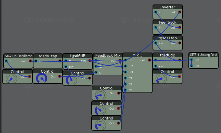

Re: IRR Filter desighn
With compliments to tgstgs modules:
A Schroeders All pass filter
- Schroeders Allpass.rar
- (4.01 KiB) Downloaded 405 times
- Roland Kuit Schroeders Allpass.jpg (55.42 KiB) Viewed 8048 times
Looks good Roland
- Roland Kuit
- Posts: 670
- Location: NL/SWE
Thanks Shark, but I have to test the mixers. In this case they must be linear.
Tomorrow an other day.
