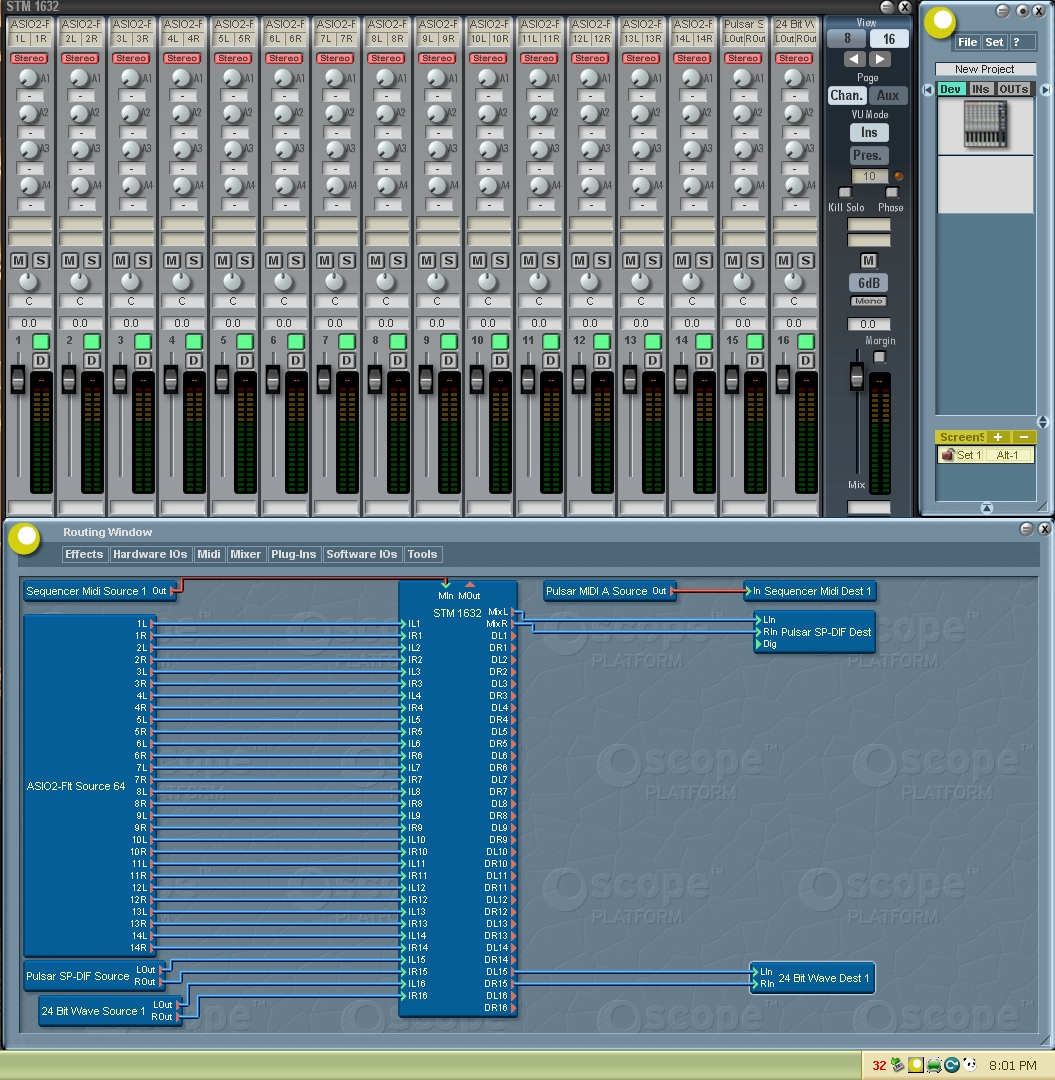

I want FL Studio to play drum samples and MIDI through Scope's STM1632 mixer, use Scope's FX and then record all audio into Samplitude. So far I figured I can only use 14 channels with one mixer, because Samplitude and FL cannot use the same ASIO driver at the same time. So I figured the 24bit Wave Source can be used with Samplitude while FL uses ASIO. Then I would use STM1632 channels 15 and 16 for WAV recording and playback from Samplitude. So my question is have I set everything up correctly?

sure, but samplitude will only record channel 15 if you connect it to channel 15's diirect out.
if that's what you're trying to do, perfect.
why can you only use 14 channels?

Instead of the spdif and wave devices going to the mixer, add a second mixer for the playback path...a dynamic mixer will do. so the 1632 mixer is always FL, and the other mixer is playback or record.

garyb wrote:sure, but samplitude will only record channel 15 if you connect it to channel 15's diirect out.
Great. Yea in the photo ch15 is already connected to direct out. I would be limited to 14 channels if only using one mixer. But I can daisy chain another for more channels.

jksuperstar wrote:Instead of the spdif and wave devices going to the mixer, add a second mixer for the playback path...a dynamic mixer will do. so the 1632 mixer is always FL, and the other mixer is playback or record.
Correct.
Use the 1632 with ASIO for Samplitude, and maybe a dynamic mixer as a submixer (like a drum submixer) for Fruity.
