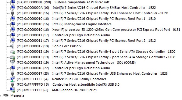

I tried to increase PCI latency timer from 64 to 128 and updated to latest BIOS version but didn't change the Masterverb test PCI limits warning.
Changing the slot from the 3rd (the more external) to the 2nd (central) PCI slot
seems to not bring big difference.
But on the 3rd slot the Pulsar has IRQ 18 all for itself alone,
while on 2nd slot gets IRQ 17 and so you can see with what share it from the image I attach.
I didn't tried slot 1 for now (cause the HD7850 videocard is two slot wide).
I will try another day perhaps removing that and using the onboard videocard.

the IRQs sharing image
Pulsar2 IRQ B75 sharings.jpg (89.11 KiB) Viewed 7091 times

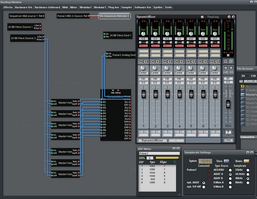

These were the Reverb test results:
Everytime I always verified if the sound passed through the reverb units, placed in parallel to the mixer, without any artifacts or dropouts. At 48 KHz:
Pulsar2 in PCI slot3 (IRQ 18 alone)
3 Masterverb (reaching PCI capacity limits loading the 4th one)
1 Masterverb PRO (reaching PCI capacity limits loading the 2nd one)
but working with two Masterverb PRO sends/returns with Mixer STM 2448 and a ASIO-Cubase VSTsynths/plugins only (no Scope synths or external hardware expanders) with satisfying performance for my usual work.
Then I changed the slot and went on on that one.
Pulsar2 in PCI slot2 (IRQ 17 shared)
(with Hyperthreading ON)
3 masterverb (reaching PCI capacity limits loading the 4th one): 6 playing fine the sound file from Wavelab.
Not able loading the 7th Masterverb unit to get over the PCI overflow alert, Scope became instable and got out of sync. Anyway once resynced the Scope rate it played fine the file through the existing 6 units.
(with Hyperthreading OFF)
3 Masterverb without first PCI limits warning but I went go on adding till 7 and play fine Wavelab file through all of them.
After that I couldn't try 'cause I exhausted the 6 DSPs power.
I saved the project, closed it and tried to reload it: you know what? he didn't give me the PCI limits warning, only the DSPs exhausting. The yellow DSP bar was empty, so I tried to resync the master clock.
It worked and Scope played normally the audio file through the 7 Masterverb units without PCI overflow warning.
I was a bit surprised. It's a weird behaving.
PS: HyperThreading OFF seemed to make some difference in better at first try, but the day after when I retried the test with Hyperthreading ON again I got the PCI limits warning at the 5th unit.
I played sound through all 7 units (the maximum for the DSPs I have), so 1 unit more than the first time I tried.

B75 Masterverb Test 7units image
B75 Masterverb Test 7units reduced.jpg (124.32 KiB) Viewed 7091 times

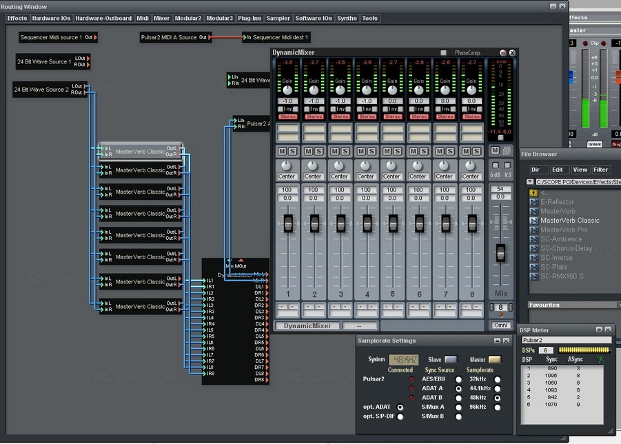

6 MasterVerb Classic without PCI limits warning. (what's the difference with the other Masterverb? I see it uses less DSP power).
With difficulties I made to connect to the mixer also the 8th but after some retries I made it play with all the others.
Of course I reached the available DSPs power, so couldn't go on.
Closed it and reloaded the saved project: it opened without any PCI limits warning and the audiofile played through all 8 units without problems.
I think it's a bit weird it doesn't give warnings at all.
Polarity
Posts: 147
Joined: Sat Jun 02, 2007 8:36 am
Location: Milano (Italy)
Re: MSI B75A-G43 (intel B75 chipset) testing and results.
Post by Polarity »
B75 Masterverb Classic Test 8units image
B75 Masterverb Classic Test 8units reduced.jpg (145.06 KiB) Viewed 7091 times

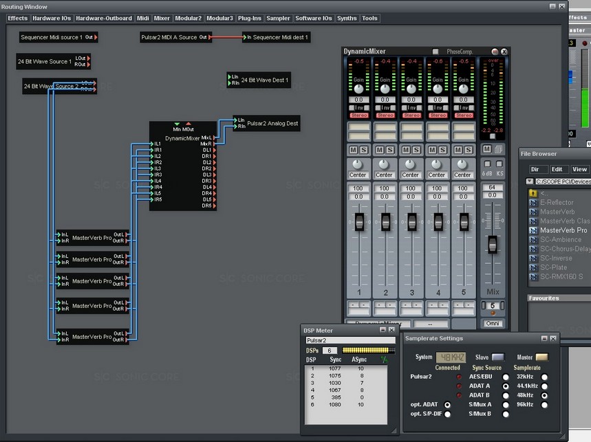

2 Masterverb PRO without getting PCI capacity limits warning.
Got it loading the 3rd one, but didn't get it loading the 4th one.
Got again the warning loading the 5th unit.
Anyway it plays fine the audiofile through all the 5 Masterverb PRO units.
Then I had no more DSPs available.
Again saving and reloadind the project I got DSPs warning and empty bar and no sound: resyncing the Master brought Scope on service again and played soundfile fine through all 5 units.
Reloading again and again these two projects (even the day after), with Hypertherading off or on, I got same behaviour.
Usually I work with one MasterVerb PRO only connected to my STM2448 project, just as a glue for sounds coming from different sources.
Polarity
Posts: 147
Post by Polarity »
B75 Masterverb PRO Test 5units image
B75 Masterverb PRO Test 5units reduced.jpg (115.24 KiB) Viewed 7091 times

first thing to do (apart from the obvious reinstall) is to disable onboard audio. also disable whatever other devices you dont use. Unless you have special needs i dont see why you have two hd audio devices running. "Active management technology"? try turning it off if you do not have state secrets on your pc!
