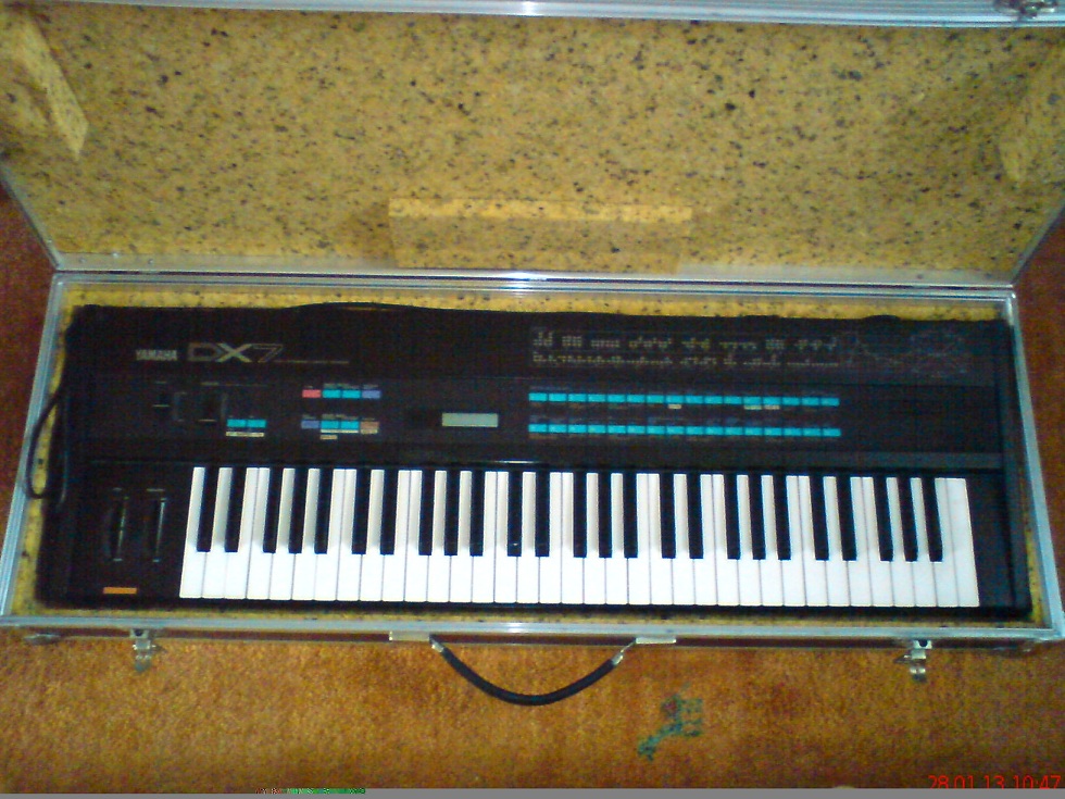

legendary vibes
- DSC00159.JPG (267.81 KiB) Viewed 25665 times
