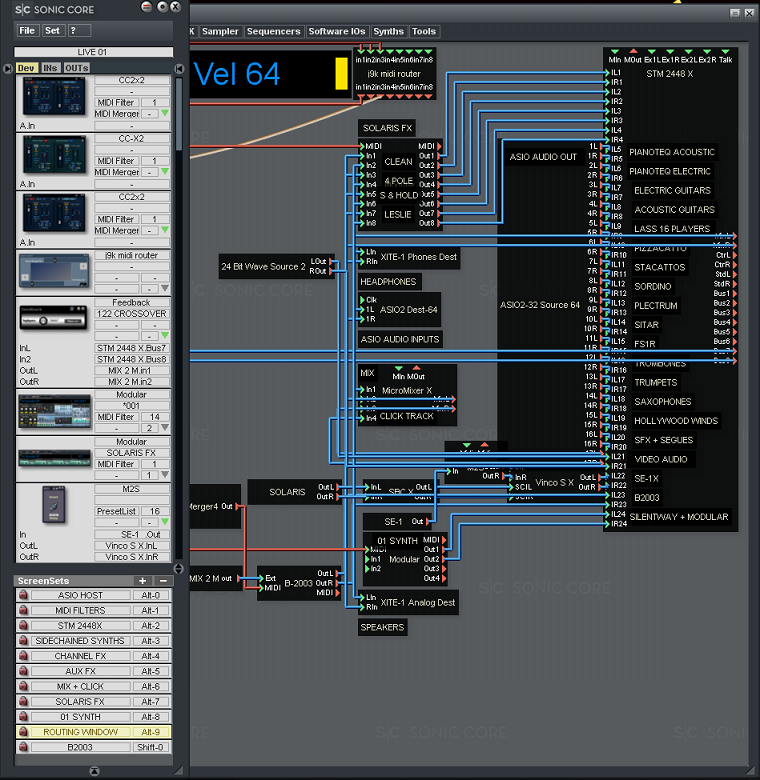

I really find that the SpaceF Blue and Red Notes really come
in handy when things start getting busy.
This is my most favorite recent Live project.
What's cool is by clicking on any of the devices in the Project
Window the Notes go into their translucent mode where the
Modules are on top, but still beneath are the Notes which are
easily readable.
DIAPER LIVE 01.PNG (299.12 KiB) Viewed 6513 times

Re: SPACEF Notes
Posted: Sat Jan 19, 2013 5:04 am
Looks good.
Great project !
What´s the "Clean 4-Pole S&H Leslie" ?
Re: SPACEF Notes
Posted: Sat Jan 19, 2013 7:35 am
Solaris is split into 4 x Stereo I/O's in a Modular Patch where I have 4 x Stereo Inserts w/ Effects.
1/2 is a Clean Signal going into a FAT II-S, Then the MIDI 4 Pole Filter
Then the Interpole S & Hold Preset, then the Leslie, which goes into the STM2448X, then passed out of BUSS 7/8 to the Feedback HPF Filter where I use a Siberian Chef (just kiddin', the word feedback started taking a hold of me) but the Filter is used as a Crossover to better emulate a Real Leslie 147 Walnut Cabinet. The signals go into the B2003 and back into the Mixer.
This way I can always add a really deep Filter using 4 pole by sliding up Fader #2 on the BCF2000, Fader #3 brings in a sample and Hold much like "welcome Back My Friends" by ELP, and this sustains so I can reach over to another keyboard, the 4th Fader of the BCF2000 is how I can bring in a Rotary Cabinet to Solaris, which really sounds reminiscient of old Yes Guitar and Vox parts on Close To The Edge LP..
I sold the Neo Ventillator since I can get better Grind for that Steppenwolf sound from SAWs and Dynomic.
The Vent had 2 x MonoPrice converters for using in a Scope Project window w/ TosLink (1/4" to ADAT and a ADAT to 1/4" for total Digital connections. I got my money back -50 bucks, so it was OK.
I can get great distortion from SAW though, it just has a different approach as it cuts away frequencies/harmonics with control called Angle and then using the Frequency selectors in Dynomic real dials in the right areas..

Re: SPACEF Notes
Posted: Sat Jan 19, 2013 12:22 pm
by jksuperstar
SAW is included with the GOST Harmonic Bundle (Dynomic).
More info on both:
http://www.sonic-core.net/documents/gost-saw-en.pdf
http://www.sonic-core.net/documents/gost-dynomic-en.pdf

Re: SPACEF Notes
Posted: Sat Jan 19, 2013 2:32 pm
I especially like the Notes when the Modules are on top, and the Notes turn Transluscent.
Re: SPACEF Notes
Posted: Sat Jan 19, 2013 3:10 pm
by hubird
realy great:-)
Very helpful for a default project if you have to mix different songs of the same band/project with not exactly the same instruments.
Sometimes you have different number of guitar tracks, wether or not synths, second voices etc.
I have a basic fx setup for each type of instrument ready for start, I delete what's not used in the current new song.
This Notes trick makes it easier to connect the inputs to the right type of instrument channel, like guitar-solo, synth 2 etc.
