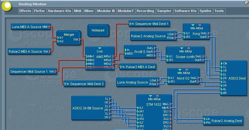

Here is some basics about routing (you need to make a Scope project with the I/O parts shown) before you start any other audio applications that use them.

Re: Is there something wrong with my hardware?
Posted: Wed Dec 26, 2012 5:49 pm
Yes, as long as you have 'routed' those devices in your Scope project.
Scope is like a regular soundcard in that it has I/O but that I/O is not connected to anything until you load a Scope project with that routing (virtual connections represented as graphical 'cables'), or you start with a blank project and route it yourself.
At a minimum, to hear yourself speak through your speakers, you need to drag/drop 'Analog IN' and connected virtual cables to 'Analog Out' (with maybe a mixer channel in between for level / gain control).
Thats in addition to the physical cabling of connecting the mic (via pre-amp) to Analog IN and Speakers to Analog OUT of the card (or XITE jacks).
Loading up Scope without any routing project, is like having a soundblaster without any solder connecting the components.
No routing (RED for MIDI, BLUE for AUDIO) means no signal flow. See below for example routing, where synths are routed via mixer to output:
routing
routing
Posted: Wed Dec 26, 2012 6:29 pm
Ive added a graphic to my previous post, showing example routing. No project running = no routing = no signal.
Thats why theres a default project that loads when you open Scope, to at least establish some default signal flows.
