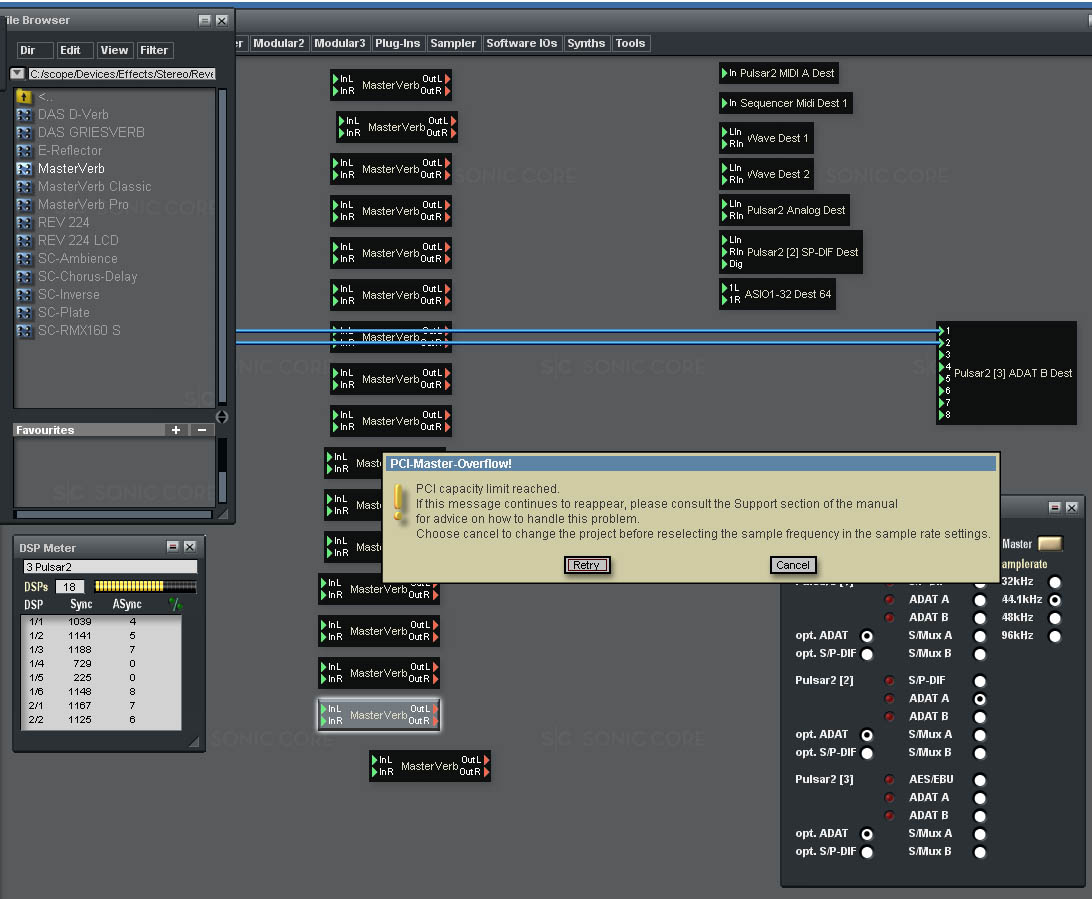

Right, I've rebuilt my DAW with a Gigabyte GA-P75-D3/I5 Sandybridge and done a quick in place XP install so the drivers were all still on the original hard drive. I installed Scope 5.1 and copied my original Scope folder over the new install (I usually do this if I reinstall so it keeps my settings etc).
Inital results were better than I could have hoped for. I managed 16 Masterverbs with a PCI bandwidth error at the 17th. I even connected the 16 Masterverbs in a chain and got sound going through. This is better than I used to get with a CUSL2-C and a P3-800.
DPC latency is 15-16 uS with Scope running.
I hit a snag when I tried loading an old project; the PC spontaneously rebooted. I narrowed this down to Masterverb Pro, putting one into a project causes a reboot. Mixers and SC reverbs are fine. I suspect that I need to do a proper format and reinstall.
So far so excellent.
Stratt
Stratt
