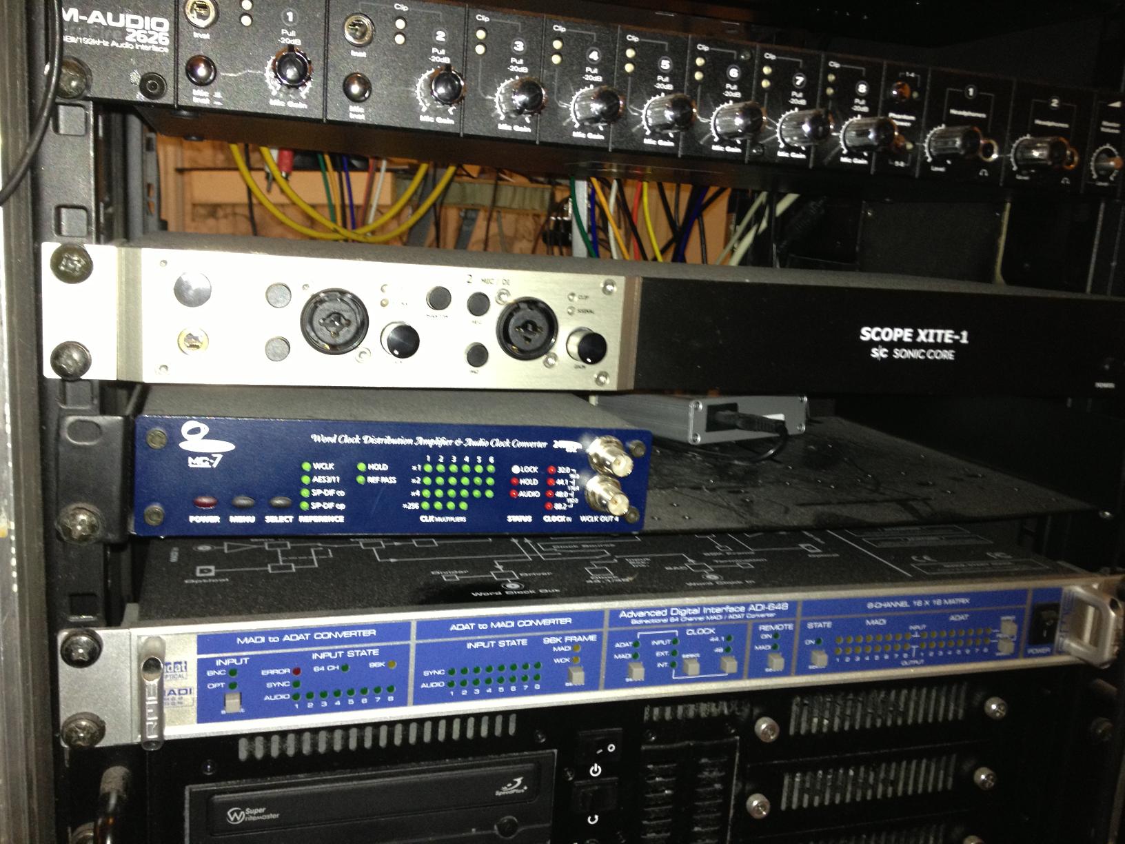

About BNC Wordclock
We use paralell sync with Mutec MC 7. ( See pic under Xite )
MC 7 is amplifying the BNC signal
Thats because we have so many ADAT
We use all ADAT very close to each other,
Because BNC is not as stable as Optical,
when using for example MADI,
For Wordclock we then of practical reasons
have all ADAT very close .
BNC cables only 1,5 m
The Mutec MC 7 is amplifying the BNC Wordclok sync,
but also all BNC Wordclock cables are made paralell.
Thats making the Wordclock Sync really stable.
You must use 15 m BNC and also ADAT that long.
I dont know what to answere .
We have so many mixers , but use only one.
Thats a monitor for the earphones.
Scope mixers has retiered them all.
We are now investigating in having three small,
summing mixers from SPL only, for 3 groups on our real drums .
For Wordclock sync Design ,
please call Thomann free telephone support.
They will give you all answeres ,without having to buy first.
Bear
RME 1.jpg (274.62 KiB) Viewed 5557 times

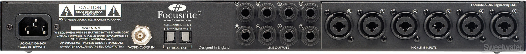

Octopres don't have optical inputs...
the analog outputs are just direct outs for the mic pres.

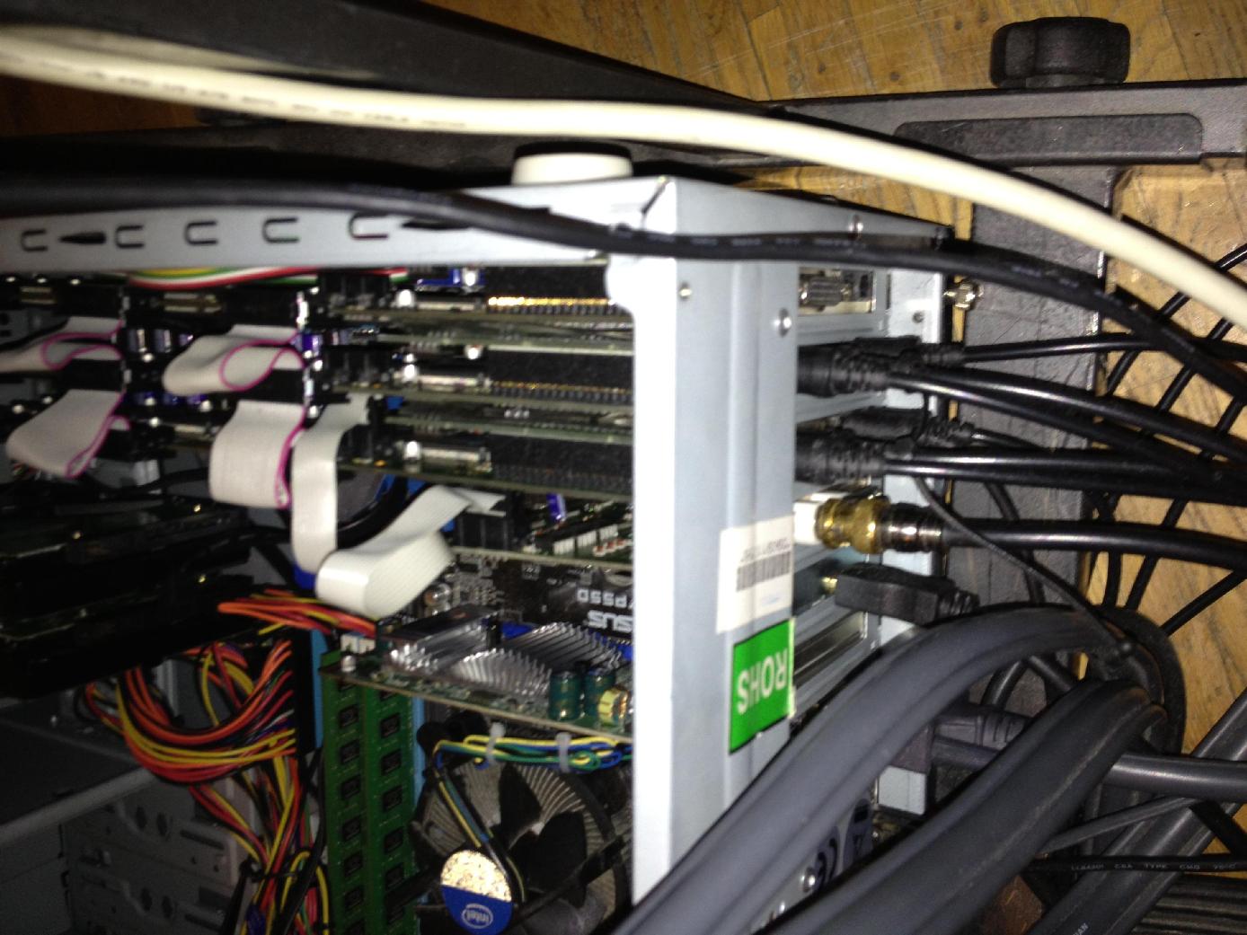

Here is our 45 dsp PCI Scope with 6 ADAT,
with the Sync Card we got from Ferrofish .
They have more cheap ADAT to MADI converter.
Not expensive at all.
For the future the RME ADI 648 maybe is better.
I dont know.
We dont yet use nr 5 and nr 6 ADAT on our 45dsp PCI,
even though we really have many analog channels in
coming also through ADAT.
Bear

Re: Maximum distance for ADAT/wordclock
Post by guppy »
No, I got a focusrite octopre mk2, which have 2 adat input and 2 adat output (it can convert 8 channels with s-mux for 24/96 I/O).
As it got wordclock in and out, I manage to sync it, but I dont have any signal from the output (where I take signals for ear amps and stage monitoring), and sometimes no input too (which is dedicated to a drum).
The problem is maybe that I don't have a good wordclock (the scope card give the clock)
