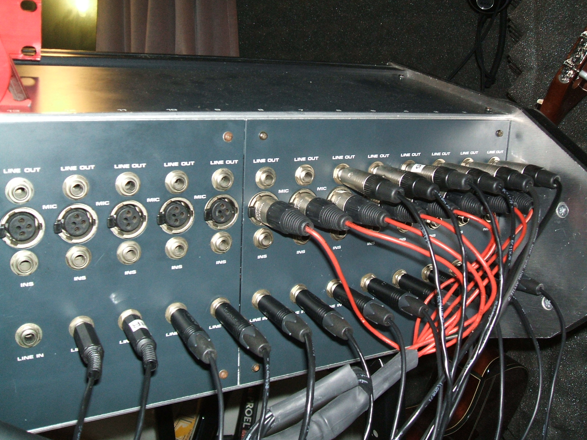

yes the problem in the soundcraft control room .
i put mic rec on direct out into zlink in and record then i out zlink for master on soundcraft.
but no run pan pot of the mixer , i think.
soundcraft custum 600 ( 16 chanel more 8 bus)
i don't know .

Line Out is pre-panpot but post-fader on the Soundcraft 600
http://www.soundcraft.com/downloads/fet ... des&id=666
