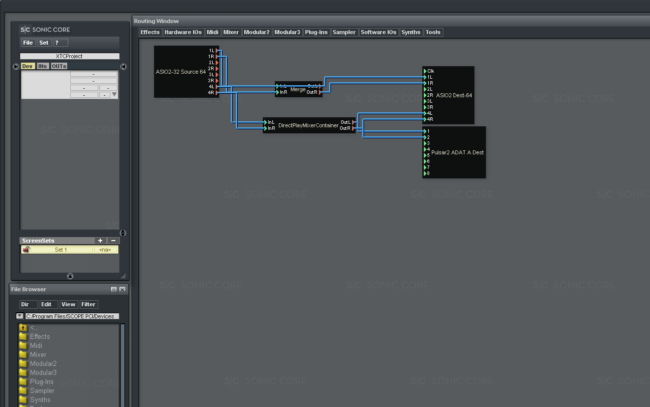

I then start up Live and get the first error message saying something about Pulsar not supporting 256 interrupt block size (intBlkSize=256). The error message suggests I remove the intBlkSize line from my cset.ini, which lets me start up Live and run it in XTC mode it seems. I don't get any sound, though, simply because I need an ADAT Dest module for that (that's just the way my gear is wired). Up until this point I have run the default XTC projects with no changes. What I do now is to edit both XTC.pro and XTCProject.pro projects (since I don't know which one it's actually using for XTC mode - better to be safe than sorry, right?) and add an ADAT Dest module and connect one channel from the ASIO In module to one of the ADAT outputs, nothing more - nothing less. Everything else is like the default.

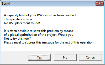

After saving the projects and shutting down Scope in XTC mode and starting Live again I get an error message like: "No DSP placement found". If I disconnect the ADAT module I don't get the error message, meaning I can even have the ADAT module in the project as long as I don't CONNECT it. But as soon as I wire it up I can't load the SCOPE ASIO PCI driver in Live.

I attached a dump of the error message and of my Scope project. The message says that the limit of my cards have been reached, which I highly doubt. How much DSP power does an ADAT module take anyway? ;) The only difference between working and non-working Scope projects is that I added the ADAT module and hooked it up.
