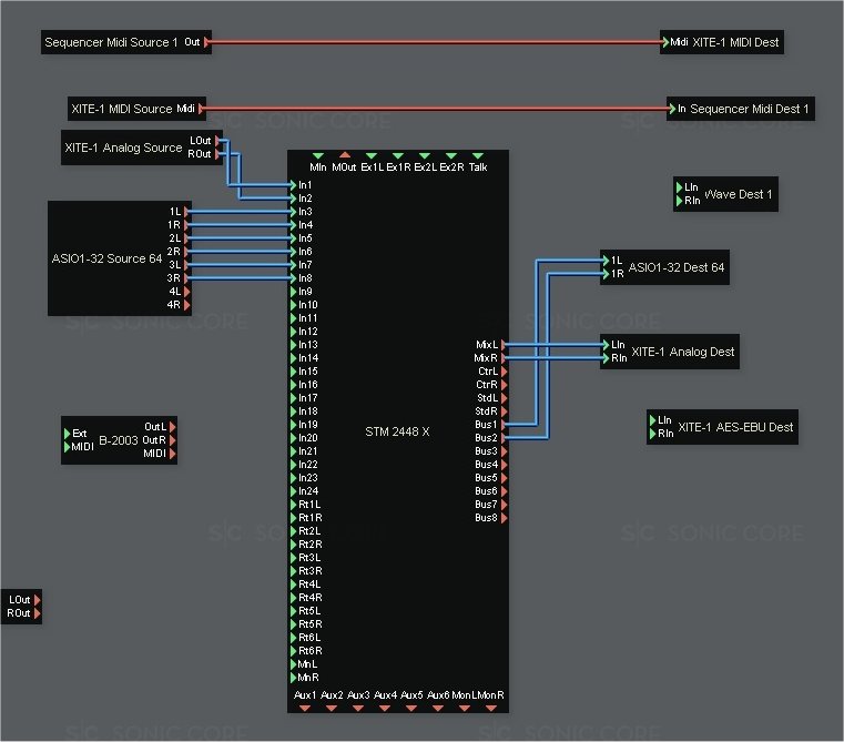

Try posting your system spec., and maybe a screenshot of your project.Ricardo wrote:Well, that was a confusing experience. I installed MIDI-OX OK. Once I opened SAM X PRO and Scope, I tried to get the LPD8 happening. At first it told me there was not enough memory to include the LPD8. Then I disabled the XITE MIDI ports and got the LPD8 happening.....only, I couldn't program any more MIDI channels, leaving me with only one channel. Thinking I'd go back and reinstate the XITE MIDI 1 & 2, these had been knocked out by 'an external error'. Basically it was all a bit unstable, sometimes sort of working and sometimes getting nowhere.
Is this a W7 64 bit issue? Or may be I have something configured wrongly? I'm quite confused, especially with the not being able to program a different MIDI channel.
Can anyone cast any light on this?
I'm now suspecting a driver conflict in your system.
Does Samplitude see your LP USB input without Scope running?

Sirius here is my project and specs:
I'm running W7 64 on intel i7 2600 3.40GHz
GA-Z68X-UD3R MoBo
8Gb RAM
ASUS Graphics GT520 1GB
No previous issues experienced. I could disable a few peripheral ports, USB2 and 3 etc.
May be it's a Samplitude thing. I should may be contact them.
