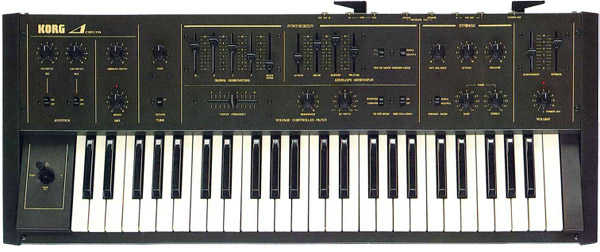

Underrated in its day, a 'string machine' with a synth section as well. It has several strengths such as full polyphony, simplicity and instant layered gratification. Plus a unique sound somewhat like a cross between an organ and a synth, possibly due to the synth section having additive square oscs w/ sliders like a drawbar configuration (16', 8', 4' and 2').
....character makes up for simplistic synthesis
Delta
Delta
The original never had MIDI or patch memory, so bringing it into a modern day replica with these added, could be popular as Im reasonably sure it hasnt been done yet (except maybe only sample sets ?). I would pay as much for this as any mid range Zarg synth.
