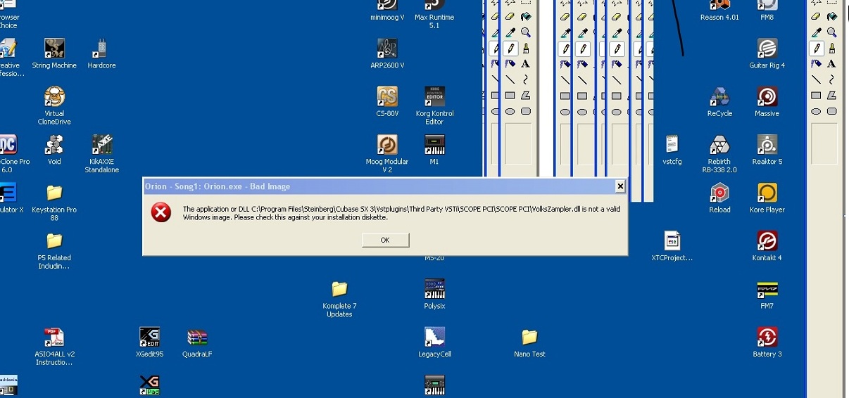

This is the error message I got when VolksZampler showed up in the list for one of the DAW's but wouldn't load----This error is also shown when I try to use STS 2000P----
This pic has been cropped too so should not be too big (I hope)
XTC errors.jpg (145.88 KiB) Viewed 22244 times
Probably got XTC mode working reasonably well but would like some help for one final push to get it working as well as possible without taking too much more time up-----

Did you rename the original STS 2000P.dev to .dll? You shouldn't use that method - rename it back to .dev, and then go into you XTCApp folder. There should be a .dll in there that is named "VST Instrument" or something similar.
Copy THAT file into your VST plugins folder, and make sure the STS 2000P.dev file is in your XTCApp/Devices folder somewhere.
Rename the VST Instrument dll file to STS 2000P.dll, so when you scan for new plugins, it should pick it up.
