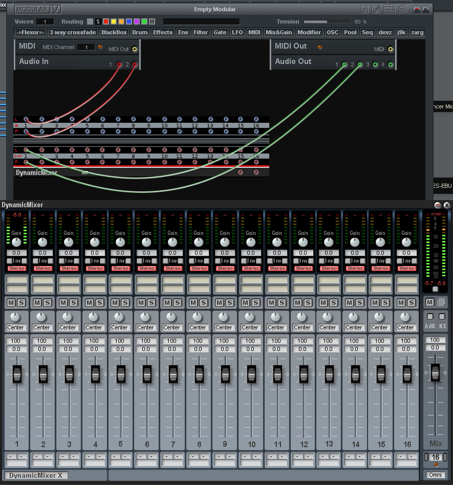

dynamic_mixer_x.zip
dynamic mixer modular adapted
scope v5 needed
any modular version is fine
this mixer uses dynamic pads and this doesn't work inside modular, so:
the first time you open the dynamic mixer it has everything enabled, all stereo channels are on, but if you switch a channel to mono, it will use only left channel
this is ok, but if you switch back to stereo, it will not restore the channel on the right.
Needless to say, before of saving the modular patch, be sure you have the right mixer configuration, then it will work flawlessly.

in the next update i will add the option to change the cc assignment on the module panel.
The micro and dynamic mixer are using cc 116 and they don't need midi in inside the modular, because the cc assignment to faders is inherited from the modular shell.
