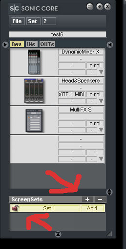

if it's only for arranging scope devices, you should try the built in screensets bookmarks.
First arrange your scope windows, then lock the preset, then add a new one, arrange windows, lock the presets and so on.

djmicron - that's an interesting idea, I had forgotten about that feature. Will try it out, thanks!
