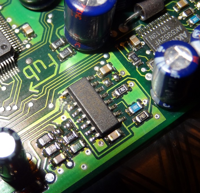

indeed the truth about the issue has been revealed: a chipset broke/lost a leg, see the photo, and also the 1st leg is not touching the board.

Post by 53E7 »
I think this can be repaired. The far leg could definitely be soldered back on. The inner one where the leg actually broke off might have enough metal left to solder a small jumper cable to patch it back onto the board. You may have to scrape away some of the plastic on the chip with an x-acto knife to have enough metal to solder to. I'd certainly give it a go if you have some good soldering skills and a decent iron, or know someone who does.
Re: STDM connection error
yep.
