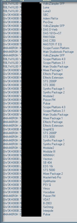

I am using Scope 4.0 as 5.1 is having issues with the STS samplers, my question though is, is the STS 4000 not included with SFP 4.0, I do have STS-5000, but no 4000?

you should probably have a 4000 key. does it matter? you have the 3000 and 5000, there's nothing that the 4000 does that you don't have.
still, it shouldn't be too hard to get a 4000 key.
