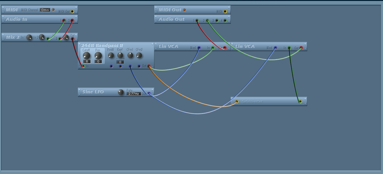

is this what u meant?guesing not since only getting sound on one side and not sure if that gate inverter is what u were talking about, sorry im a noob to modular

See here: http://www.cwmodular.org/html/mix_modifier.html
I think you need an Inverter for one channel and a Bipolar2unipolar on both modulation signals. If you get stuck, I'll try to mock something up tonight
Re: how to modulate panning in modular?
Sorry, also just spotted a problem in the routing too. So I think it should go something like this (I'm assuming you're passing a mono signal in):
Mono portion (start)
Audio signal path: Audio in 1 -> Filter
Filter modulation path: Sine LFO -> CFm1 of Filter
L Channel:
Audio signal path: Filter -> VCA 1 -> Audio Out 1
Amp modulation path: Sine LFO -> Bipolar2unipolar -> Mod of VCA 1
R Channel:
Audio signal path: Filter -> VCA 2 -> Audio Out 2
Amp modulation path: Sine LFO -> Inverter -> Bipolar2unipolar -> Mod of VCA 2
L Channel:
R Channel:
- Posts: 20
- Joined: Fri Dec 10, 2010 12:57 pm
worked
n sounds wickked thanks!
