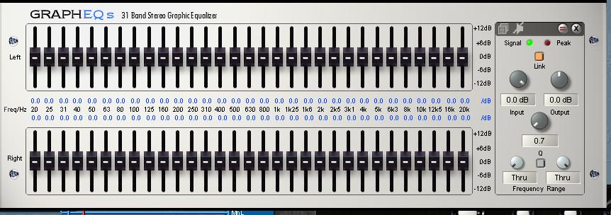

What about GraphEq?
Isn't this a Stock Device?
- grapheq.JPG (67.4 KiB) Viewed 6339 times

The issue with the fixed-band EQs is that they don't have enough frequency resolution. e.g. GraphEQs has low bands at 20, 25, 31, 40, 50 63 and 80. With a mode at 70Hz there's no way to accurately address it. DASGOST has the same limitation.

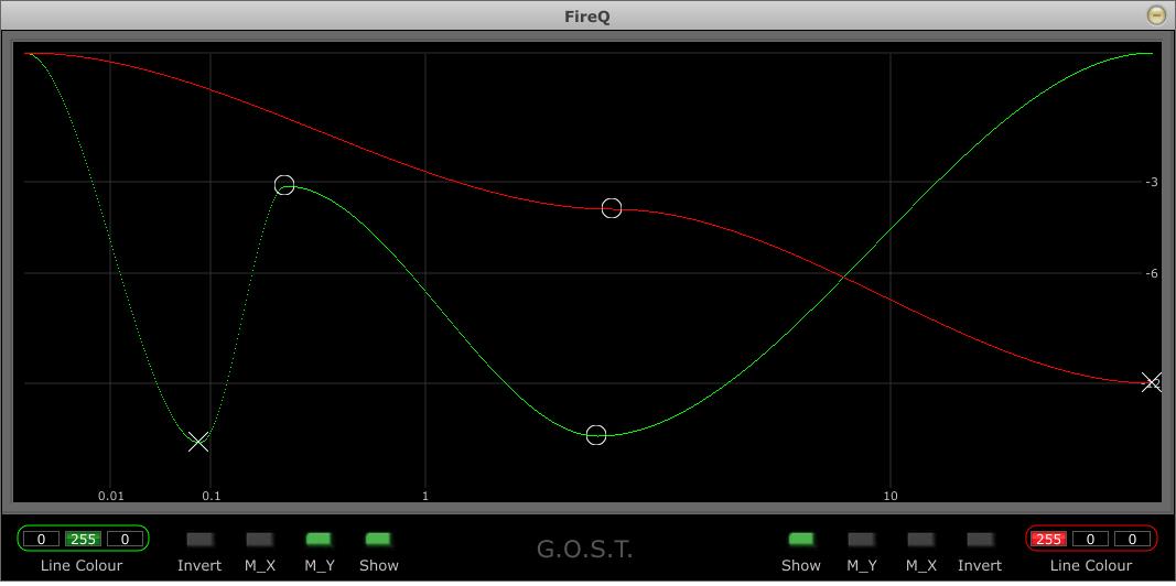

Re: Graphical EQ like PEQ4 but with more bands?
basically it is possible with feedback and adds;
thisway you may get 128 taps on 1 old dsp;
but to get out the max of it you better code your own fir in assembler;
the dsps are made for this;
readout of sample AND coeff AND multiply AND add in 1 circle;
we have a 4096 prototype running on 1 new dsp with headroom at 44k1Hz
good vibes
good vibes
- FireQ_01.JPG (49.14 KiB) Viewed 6300 times
Thanks for the insights, tgstgs.
Looking forward to seeing the finished FireQ!
