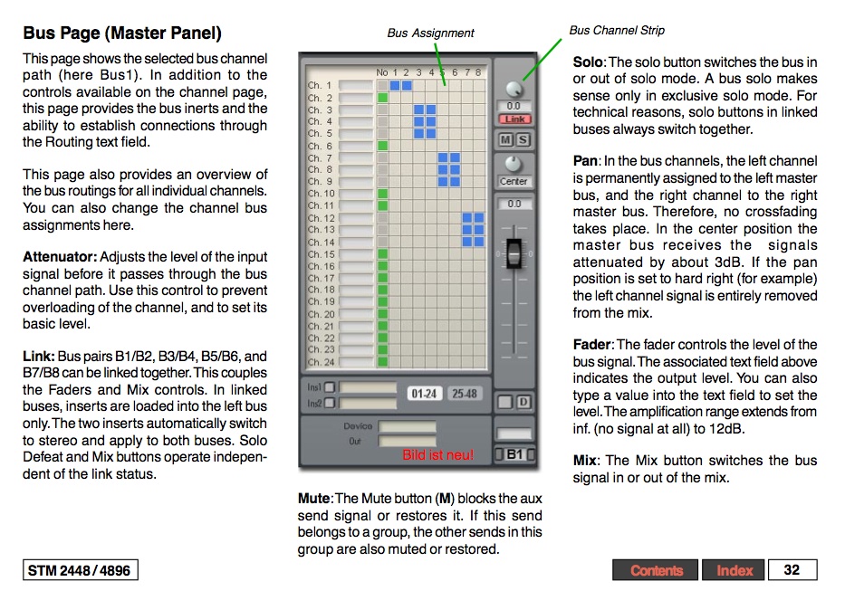

If it's about STM 2448 / 4896, maybe page 32 of the manual helps.
- page 32.jpg (295.96 KiB) Viewed 3699 times

Yes its about that page I dont understand how to activate.Janni wrote:If it's about STM 2448 / 4896, maybe page 32 of the manual helps.
The blue is automatic from loaded plugins but ???
I get no signal at all.
Also what is ment by linked together here.
I dont want to use Mix out in PCI Scope , so we dont want to link channels or busses with each other.
Also we go back and forward to Waves Multirack here using also there live plugins,
but we find Scope much better on Feedback ,Delays and Reverbs.
Thats why we want to activate the busses.
Maybe we can adress the internal Aux inserts also otherwhere than out through the 8 busses,
but thats ok for us.
We use monomixing exept for feedback but then back to mono,
after using stereo just to make feedback.
Re: The busses
The blue buttons are the buttons for assignment.
That means (in this picture):
Ch 1 goes to Bus 1&2 (linked together, red link button)
Ch 2 goes to Mix (green button)
Ch 3 goes to Bus 3&4
and so on...
AFAIK you can't send one channel to several busses.
That's really limiting, IMHO.
But I'm not sure about that, haven't used that mixer for a long time...
As long as you haven't activated the green mix button on the Bus channel strip (right bottom,
next to the defeat switch) the signal goes only to the Bus output and can't be heard on the mix.

Thank you very much, i am going to try to activate today.Janni wrote:The blue buttons are the buttons for assignment.
and so on...
If I understood right what you want to do, I would combine several small mixers and skip the big STMs.
I think spacef mod-mixers would be a very good choice for you, but I'm not sure...
We already use the 1632 on each channel separeted in our Xite before mixdown to Stereo.
In recordings we dont do so only but both.
So thats why we want to do so also in our live set up.
I am going to route the channels delay and reverb to 1 bus, but thats maybe not possible or ???

the description from the manual is about the record busses, usually called "bus".
i believe you may be asking about the auxilliary busses. they're marked "aux", but an aux is certainly a bus. usually things like reverbs are put in an aux.
auxes are enabled in each channel on the master channel panel. they are located below the record bus meters and are labled aux1, 2, 3, 4. they have a button to press to turn them on. the other button is for pre/post. refer to the manual for detail. the aux busses work just like on any other mixer.

Ok is that spacef mod-mixers on any pic somewhere.Janni wrote:The blue buttons are the buttons for assignment.
and so on...
Is it working in Scope or what lol ???
You are not sure ?
Why not
