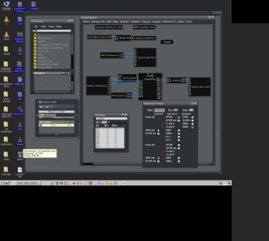

Re: is possible to record with scope khz 96 asio and cubase
here look it
- 96 khz.png (245.16 KiB) Viewed 3391 times
i dont fully understand what you wrote in the last post--- but please post a screenshot of your scope routing windows along with the dsp usage meter
at 96k, it takes DOUBLE the dsp, harddrive, memory and cpu resources as 48k does. some devices that take up several chips at 48k will need 5 or 6 dsps at 96k and those dsps may not be available on the same card or even on the same part of the card. there is a limit as to how physically far apart the chips can be and still have the device work. for that reason, you get the error and an offer to reorganize how the devices are loaded.
all problems are doubled at 96k!!!

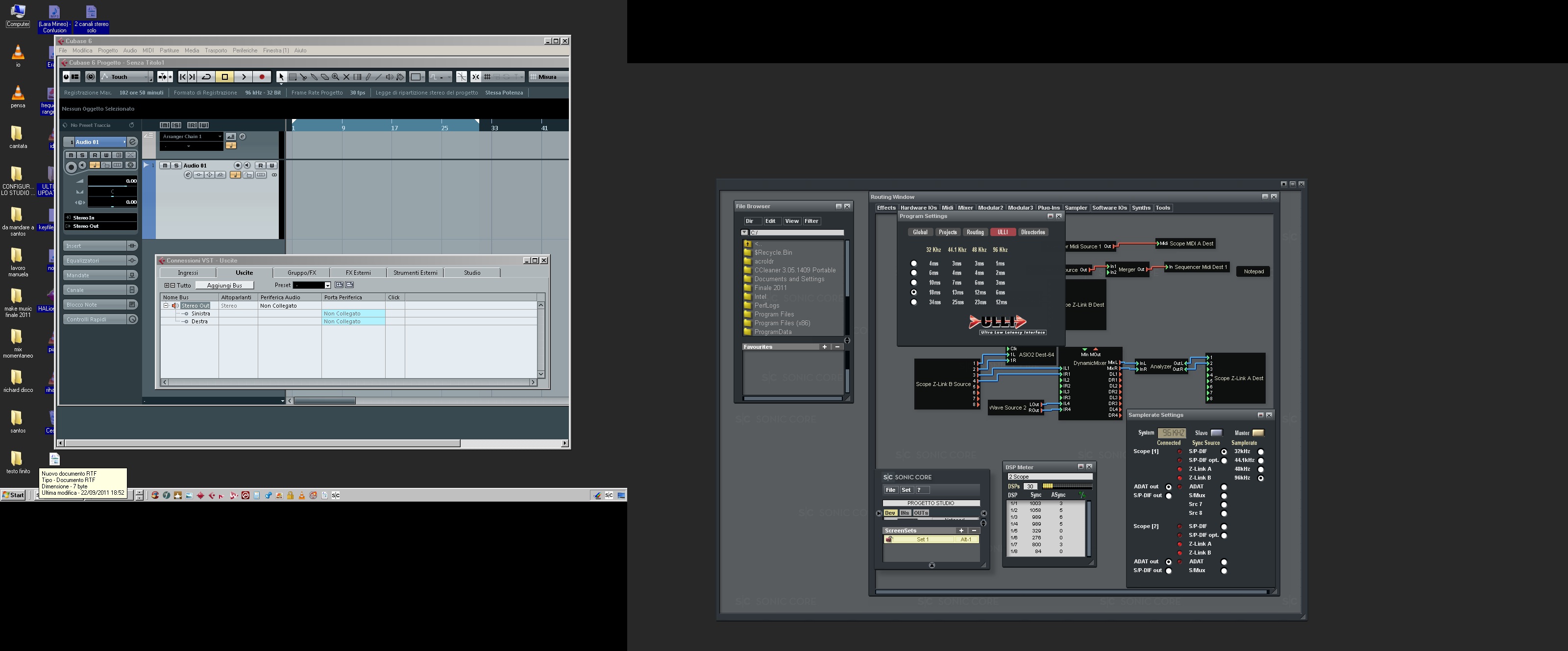

this is the project, i don't think that are there very resorce opened
- progetto.png (112.71 KiB) Viewed 3374 times
so you are saying that you get the error message that the dsp limit reached, even when it is not reached?
I get the error often, and it is solved by pressing "yes" - it doesnt solve your problem?
did my explanation not make sense?
it's a generalization about what happens, but it's how the system works.
a dsp overload, or big modules don't fit can happen before you load all the dsps, just like ProTools HD. Scope loads devices onto dsps according to rules that are designed to maximize the loads. depending on the order that things are loaded, there may or may not be room for a device that must be split amongst 2 or more dsps that are physically too far apart for the latency between chips(it takes actual time to communicate along a copper trace between chips) to allow realtime operation. in that case, Scope offer you a "global optimization", a reshuffling of the dsp loads, a redo of the order devices are loaded in, to find a working combination.
you may or may not get this message, it usually depends on the order that devices are added. you're twice as likely(at least) to see the message at 96k. that's how it is. that's one reason why one big card is better than two or three small ones. you're less likely to have chip to chip latencies that are too long to work when all the chips are on the same card.
- the19thbear
- Posts: 1499
- Location: Denmark
aha... so his newest screenshot shows the dsp usage AFTER he has hit "yes" to dsp optimizing (which it cant do, because of 96khz/the project is too large) , thats why it shows zero dsp usage, because nothign is activated... thats at least what i gather from the picture
so my advice is:
Start from scratch with a new blank routing window, set the project to be 96khz, add modules untill you get the "dsp optimize" box and press yes, if the project still works, add new modules, untill you run out of dsp. = do your work with whatever devices your can load, or buy a 15dsp card/xite
so my advice is:

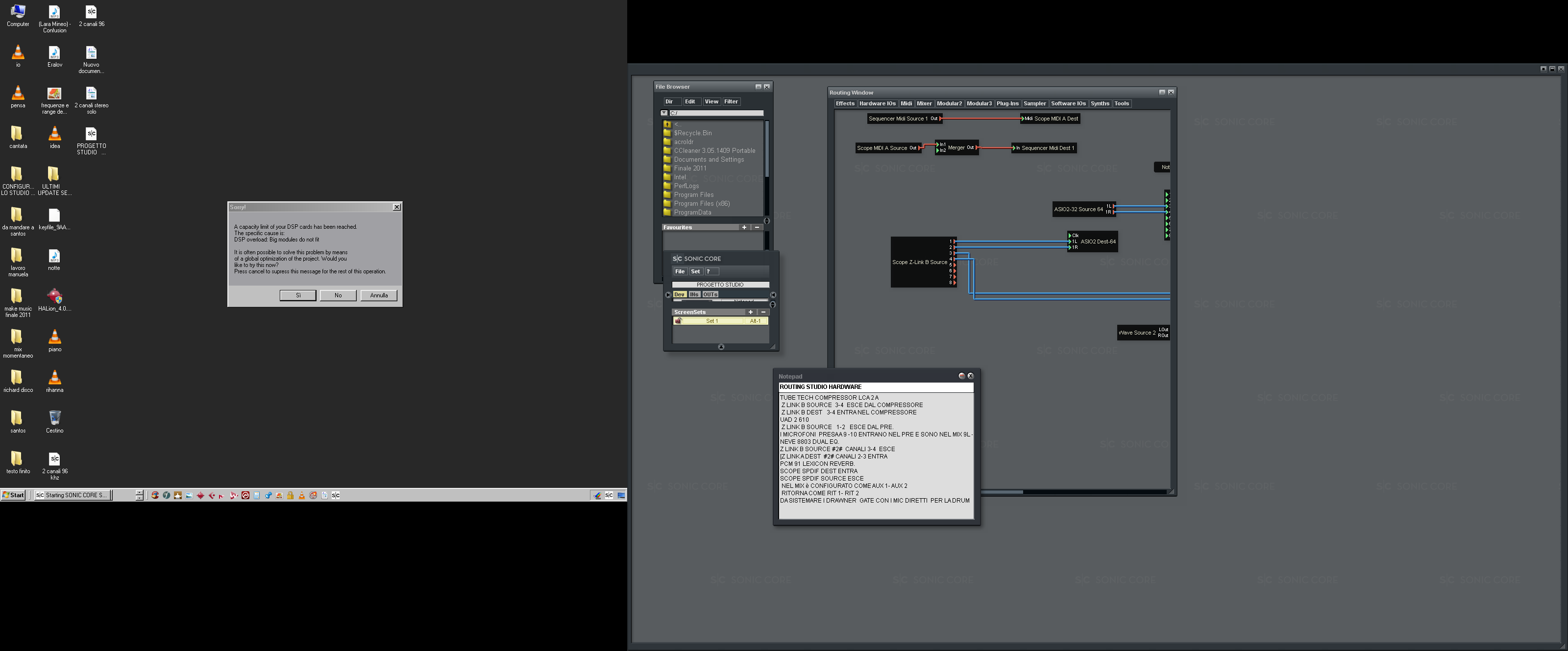

1. Did you record 96khz in another sequencer? is this something that suddenly happened whith cubase 6?
2. When you post screenshots, please post the whole routing window, with info on what devices is loaded and your dsp meter.
3. What happens when you press "si" on that error message?

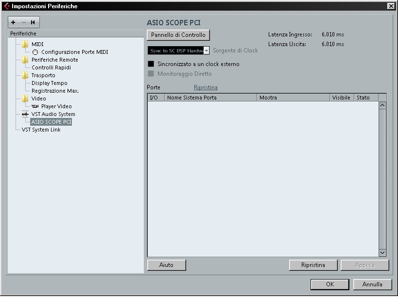

you want see my project ?
nothing hardware i think
why my resource are full.
almost believe that impossible in this moment put the asio driver becouse no it.
- this is project.jpg (217.26 KiB) Viewed 3334 times
- asio scope pci.jpg (73.65 KiB) Viewed 3334 times
- connessione vst no run setting.jpg (493.68 KiB) Viewed 3334 times
when I add a bus, not added. so it is impossible to move forward.
