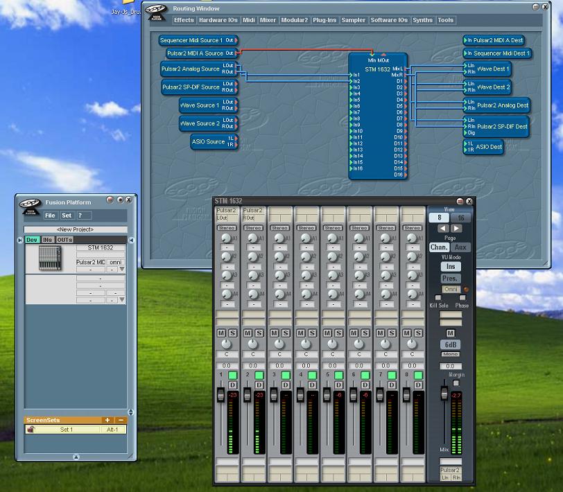

hey guys,
mobo - Gigabyte, G41MT-S2
doesn't seem to have online audio from what i see
Previously, had it working OK with this same mother board for a few days
see the pic attached - loud static noiz taking place when the Pulsar 2 Analogue Source us attached to the STM mixer.
Cable whip is not even attached so its unrelated to that
the pci contacts should be clean as its a new mobo, right? i also changed between pci slots and that didnt help.
additional thoughts?
- pulsar pic.JPG (108.23 KiB) Viewed 2249 times

Re: Distorted sound/noises in mixer - Pulsar unworkable :(
how can anything come from the analog source if the whip isn't attached?
Because the card is broken
really?
even more to the point, why even connect the analog source to anything without a cable whip? if the noise comes from the analog source, but there's nothing connected to the analog source, nor can there even be, because there's no whip, the obvious and easy solution is to remove the analog source, since there's nothing that it's useful for.
Does It distort when you connect the Adat ins/outs in scope? Or is it just the analog in?
It seems to me that the card is partially messed up - but it might be that one port only. Try the other ports as well..
