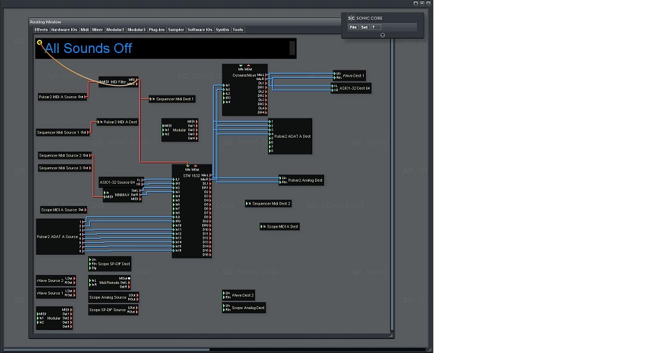

Re: Hardware Contol of STM mixer with M-Audio Keystattion Pr
Posted: Wed May 04, 2011 4:12 pm
That's way huge.
And why haven't you connected the MIDI Monitor.........?
Your KS 88 is the Pulsar MIDI Source module, that should go into a MIDI Filter, then to the yellow circle connection in the Monitor.....
You don't have to have the MIDI FIlter, but the active sensing data really is a waste of life and time.

by fraz
The MIDI monitor hasn't been connected yet as I was seeing if I could actually get the project image into Paint then upload it, which I have done but it is way too big.
The active sensing you refer to being a waste of time and life - ? please explain...
Filter connected 50% previous file size.jpg (75.74 KiB) Viewed 27633 times
OK, I connected the filter and have uploaded the JPEG and reduced it to 50% of the previous size - This is better....
Posted: Wed May 04, 2011 5:03 pm
Hook up your MIDI Source module and connect it to the stock Creamware MIDI Monitor and just watch the endless stream of worthless information.
RoyT's monitor has AS Filtering built in.
But still IMHO it's always a good habit having 4 x MIDI FIlters.
One for Seq. MIDI Source, one for Pulsar MIDI Source.
One for Seq. MIDI Destination, and one for Pulsar MIDI Destination.
