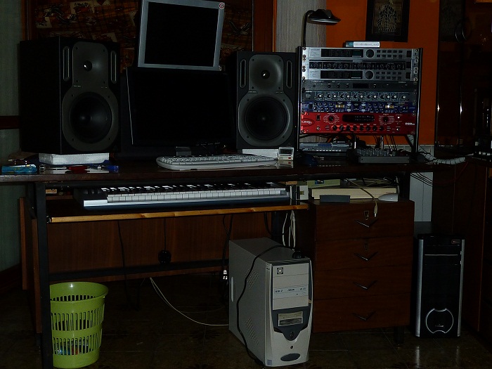

Though I'm experiencing bad issues with bass freq (almost continuos pollution from the outside probably leading to tinnitus issues), I've choose to add a subwoofer to my old Truth B2031.
I'm wondering how I should set things up.
Considering I'll gonna use 4 outs (2 stereo pairs, 1 for the speakers, 1 for the subwoofer), how should I set (software) filters for these outputs?

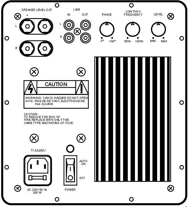

Why not get a sub that has an integrated subwoofer? I can't get the manual to work of the Behringer website but most speakers have controls for bass cut & 'room size' that can help filter the low end out of the speakers themselves, assuming the sub doesn't have pass-through connectors that will do that.

Of course B2031 has got a low cut switch (-2 to -6 dB), which they say can be used for tuning with subwoofer, but I can't find the cutoff freq stated anywhere.
As for the subwoofer itself, I'm considering a kit from Ciare; they provide cabinet components (prepared wood walls and reflex ducts) and the speaker. The cabinet is ready to host an amp module (which not come with the kit). This amp has tuning capabilities, but I'm not planning to buy it soon, I'll rather try to adapt some circuitry I've here, in first istance.

That makes plenty of sense, but you will want to filter the sub itself with whatever control it provides (lowpass filter). Ideally it should have a sweepable filter and you can set it so that the rolloffs of the speakers and the sub combine to 'flatten' where there would normally be a dropoff. That's why I was asking what controls your speakers had, sometimes using the 'half space' or raising the speaker's own low end controls (my mackies have a built in filter that has 3 steps from 37hz up to 80hz) to tune the speakers in 'full range' input to the sub...
