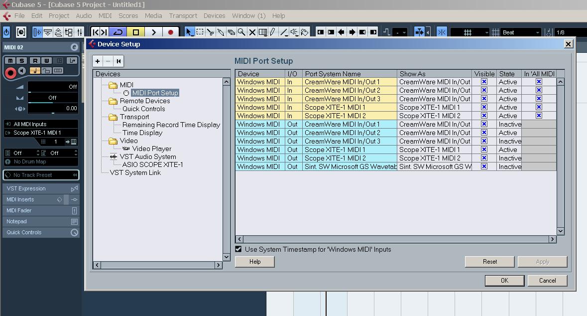

I have 3 scope cards and the xite 5.1 installed on this pc, XP 32bit. Everything works exception made for Xite-1 Sequencer MIDI Source....I'm able to record MIDI data through Seq. MIDI destination, but nothing comes back from Cubase 5.
Scope cards work with no problems.
I obviously see and choose the Xite-1 MIDI port in Cubase's track output.

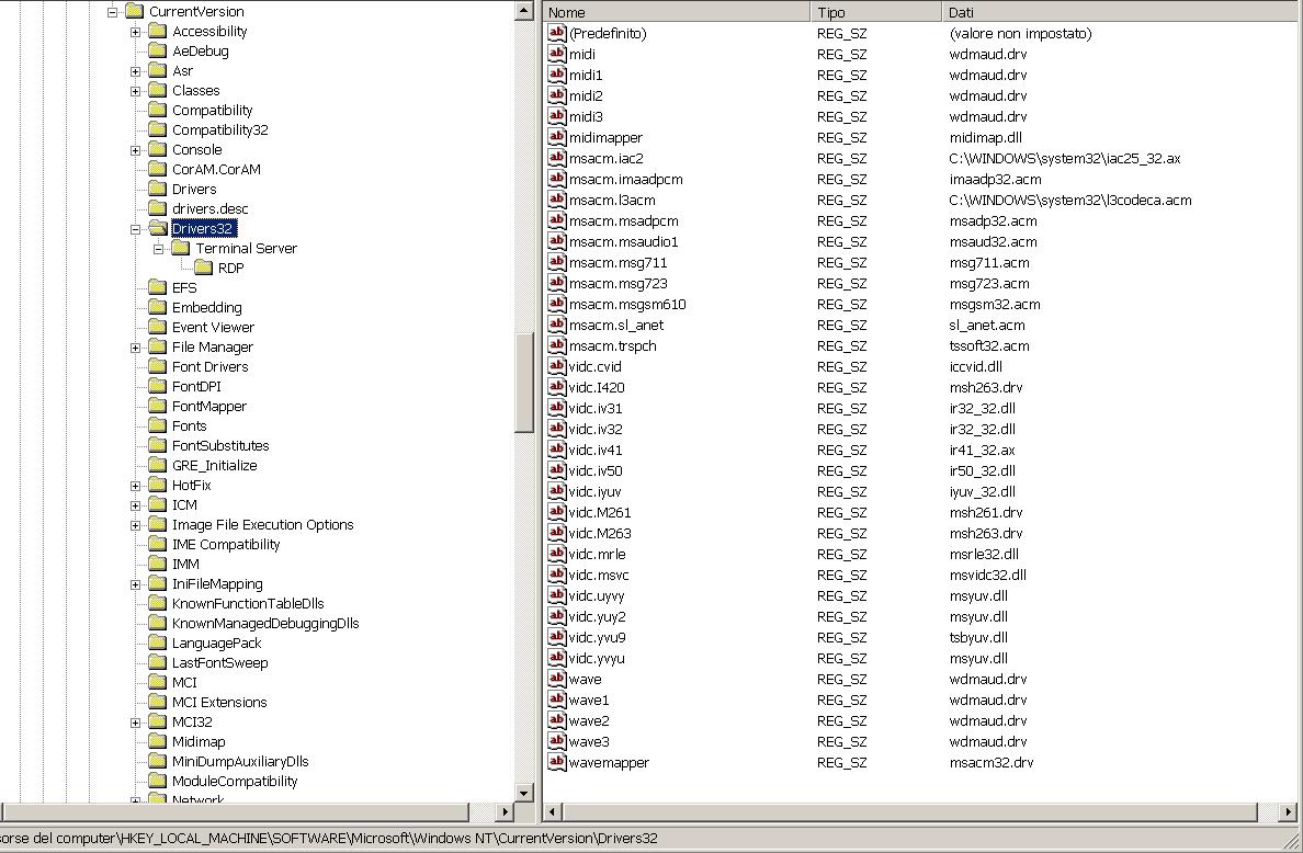

When I use Xite I don't use scope cards. This is how the drivers are listed in the registry
and how the MIDI ports look in Cubase....I remember issues with multiple register entries but I don't know if this is the case....can't remember it well.
Thanks for any suggestion! :)

I was going to keep some cards w/ the XITE-1 but I had nothing but trouble having the PCI slots and PCI-e filled, even if the MIDI from the X was being used.
I wish I knew the rgy. stuff, but GaryB has an X now w/ Cubsae I am sure he can add something instead of speculations.
