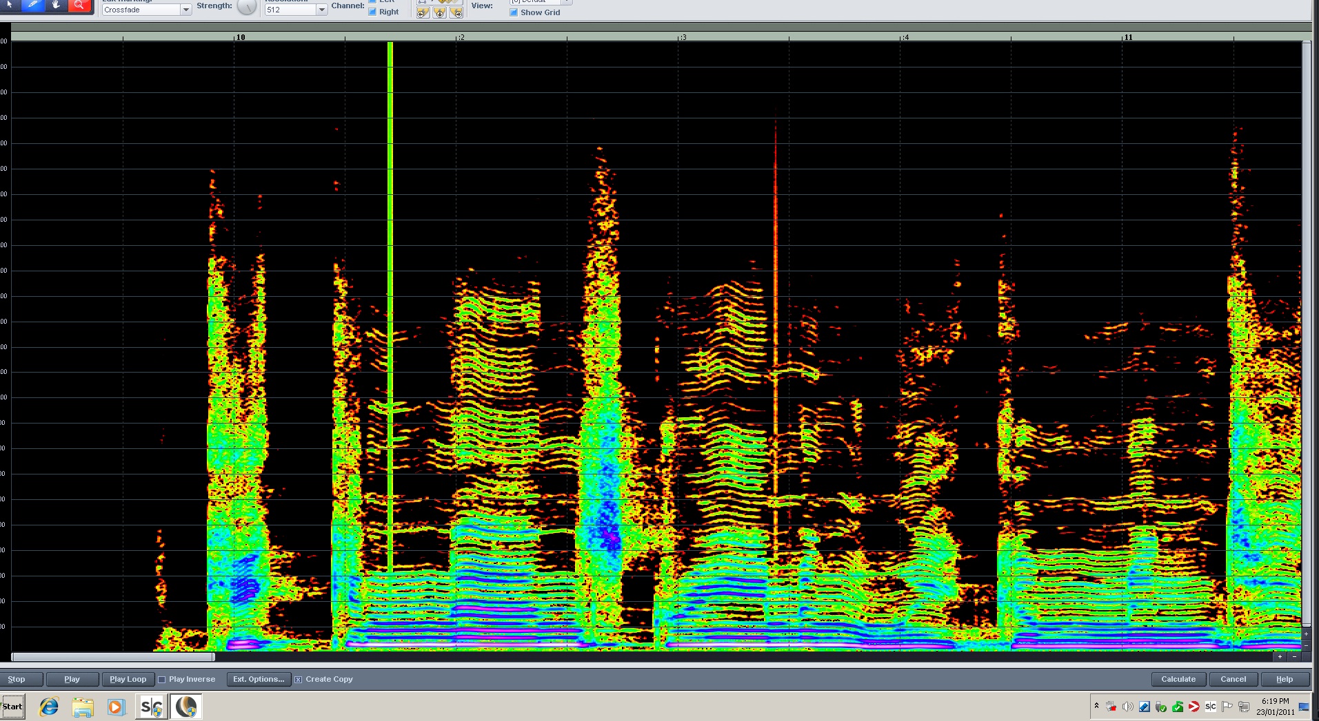

I am not sure my issue recording ADAT track into VDAT and then imported in Samplitude is the same, but it may be.
I have been bringing 8 tracks from my old ADAT into VDAT recently and have encountered some noise issues.
Some tracks have these great big clicks in them and some have a kind of furry sound.
I suspect the furry sound may be head dirt or damaged tape.
These are quite old recordings.
The big clicks I am less sure about.
The VDAT recording were done with the ADAT slaved to XITE via the ADAT B Source Module (48KHz of course).
I did not slave XITE to the ADAT source - maybe that might have fixed the problem, I don't know at this time.
I was wondering whether its SCOPE trying to cope with 8 recordings at once into VDAT.
Sort of a multiplexing click as it switches between channels.
You can see the clicks on this spectragram below.
This one has only two clicks whereas some have many more than that.
Re: Is it Jitter?
Posted: Sun Jan 23, 2011 1:41 am
just recording 8 tracks shouldn't make any pops or clicks, period.
a clock issue will always make pops and clicks. there can be only one master. when it is chosen, the other unit must be slave, or vice versa.
data travels between devices in "packets". the timing of each sample in each chunk of information(packet) must have an accurate clock for it to play back in time. two freewheeling clocks, even if they are running at the same speed, will create timing errors that are heard as a click or pop, since they won't necessarily be in sync with each other, leading to errors(the noise). one of the clocks must control the other(or both can be slave with an external clock source like bnc wordclock), so that all data from one machine to the other will have the same timestamp from the same clock. or something like that...
Re: Is it Jitter?
Posted: Sun Jan 23, 2011 1:19 pm
by mausmuso
Pretty obvious really.
Thinking about it I think ADAT has to be the Master.
I am not in the studio, but will check tonight. I dont think I can slave the ADAT anyway.
