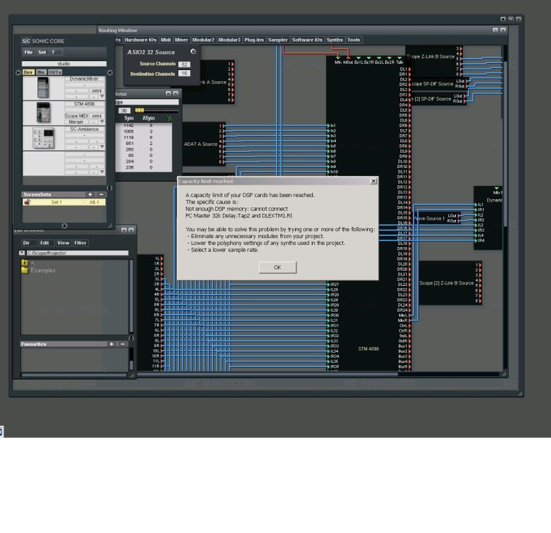

I do not understand, but if the resources are occupied by very few, 'cause I get this message?

Are you using inserts on the master channel?
I can't see how everything hooked up in this screenshot.
Which version of Scope? WinXP or Win7?

Hi, I would like to insert it into the project as a device.
I'm using version xp

you seem to have 2 Scope cards of 15 DSPs each.
I usually get the same message instead of the more common PCI overflow error in Masterverb Test.
The device you are trying to load demands a lot of resources by nature.
Are there already other reverb/delay effects loaded ?
At least you have a high amount of Asio channels going.
You may have allocated some in advance - if not all are needed this produces less stress on the bus.
Finally it could be related to the board revision of the Scope card, but that's a speculation by me because I never got the test results of some people with the same motherboard.

Infatti,guarda che rev. hanno le tue schede.Se non ricordo male le versioni a 15 dsp sono le piu vecchie,avevo due di queste schede in passato e davano lo stesso problema.
Inoltre potrebbe anche essere un problema di condivisione degli irq con altre periferiche del sistema.
