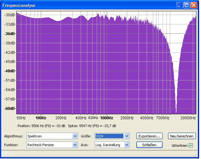

the point
even 1 sample delay change the phase (equal the samplerate btw.);
if you mix the changed phase signal with the original you get a nice LP;
this is the most simple LP filter man may think of;
could be you have more than 1 sample delay between dsps who knows . .
now the question
what would happen if you mix it up?
sorry thought there is more interest in some serious discussion resulting in some funny code for a nice free device;
good vibes from vienna
now the question

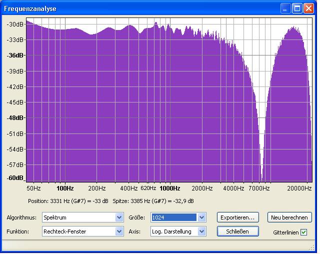

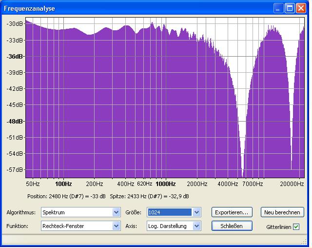

the smallest math number is 1 sample delay right;
but the probl. is that already 1 sample delay has a hugh effect to the frequency spectrum;
you will hear it for sure even in a low level mp3 on a 15euro headset;
btw. the cassetrecorders of back then had much better quality than any mp3 today;
as rule i would say:
check your lines (for lenght / delay)
be it the cables in your studio the reflextions of wall in a concerthall;
the reflextions of the speakers desk compared to the directsource or
the blue wires in your scopexiteproject window;
as soon as there are different delays you are creating primitive filters;
combfilter vibes from vienna

lets take some white noise dublicate delay one stream mix together
and see what happen:
1 SAMPLE delay!!!
even a lowquality mp3 has a better frequency response no?
1 SAMPLE delay!!!
maybe some people aboth 80 cant hear a difference;
- WhiteNoise_1sample delay.JPG (68.46 KiB) Viewed 8034 times
