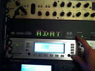

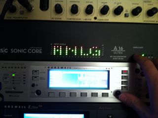

Well, I think it IS possible!
Because you can switch the inputs on the Z-Link connected A16 from analog to the ADAT lightpipes (via the Sample Rate Button, shows up the mode via the LEDs, reeding "ADAT" or "ANLG", see pics)
So you could add another A16 via ADAT, switch the first A16 to "ADAT" and there you are, running the analog inputs from the second A16 to its ADAT outputs, going into the ADAT inputs of the first A16 and through ist Z-Link conections into the Xite-1.
I use this feature quite often, runs like a charm! :)
sure, but there are still the same number of i/o in Scope. it's either/or...

auricle wrote:Indeed. I need 32 I/O of the two A16 boxes PLUS the 16 I/0 of the Xite adat I/O
So you mean simultanously? Ok, that is indeed not possible. But otherwise you can easily switch between the inputs. If you need to have the machines plugged into both A16 playing all together, just record the first set and then the others, the rest is DAW. :)
