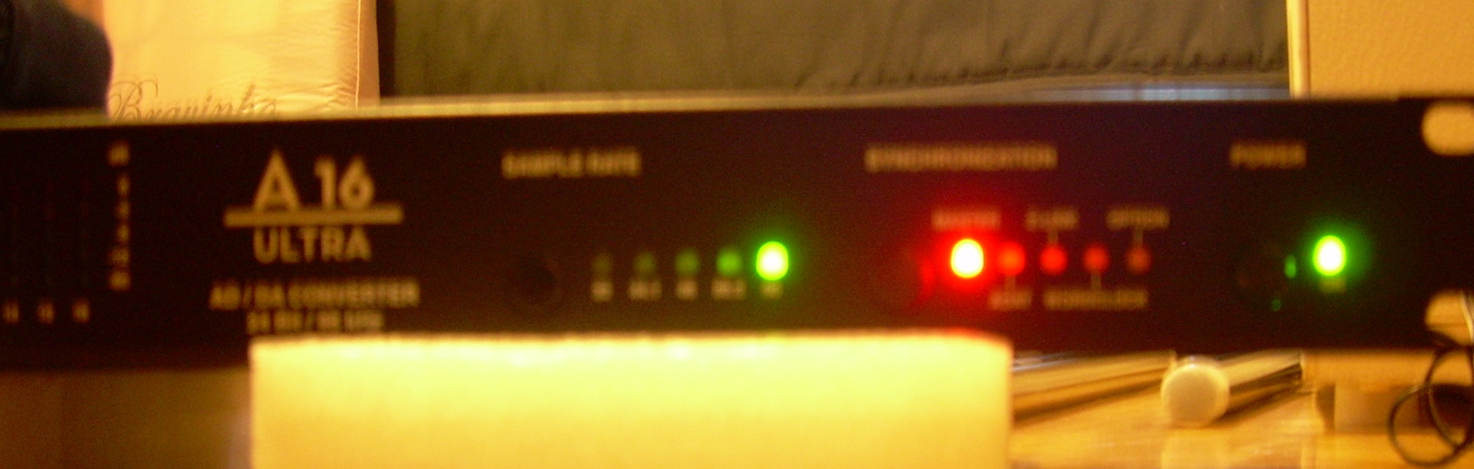

Hello. After 15 minutes working my SC A16 Ultra (black face version) get out of sync (sync led go to red) only in 96 kHz and 48 kHz. The same happens if set A16U in wordclock and setup my RME fireface 800 as a master. If I turn off A16U for a 10/20 minutes and turn on again, green led appears again, but after 15 minutes red led backs.
SYNC: Master (green led before 15 minutes, them goes red )
SAMPLE RATE: 96 or 48
SYNC: Wordclock (green led before 15 minutes, them goes red )
There's any solution, or I should contact SC support?

- After 15 minutes
- SCA16UAfter15MinutesWorking.JPG (799.42 KiB) Viewed 1770 times
- Before 15 minutes
- SCA16UAfter1MinutesWorking.jpg (205.84 KiB) Viewed 1770 times

My tester was out of battery and I did a wrong measure, correct value is now 14 VAC (I already know about no load measure values). I did several test with WC sync and I'll test whit ADAT sync ASAP. But I think there is something wrong in my SC A16U due it lost sync in master mode in 96 kHz even if there is no any cable connected to the machine only the power supply, that happens about 15 after I switch on.

yes, if you can repeat the error condition after 15 minutes there's probably a part within the A16 overheating.
Most likely by the internal power regulation, but I have never seen one from inside so I dunno how it is constructed.
Nevertheless it's probably the only part of the device that can be serviced without special parts or information.
(just in case you want to avoid shipping - your nick suggests Spain as your location...)
