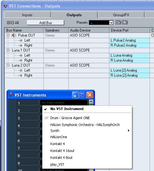

Trouble is Im an XTC newb so not getting far. Ive engaged XTC mode, then closed down Scope and started Cubase
Then going to VST instruments, where Kontakt and Halion etc show up - but no Scope instruments. What step have I missed ? As you can see the Scope I/O's are all there but cant find instruments. And the Scope manual about XTC is showing an ancient version of Cubase.

Re: XTC good news and bad news w/ Cubase 5.5.1 and XITE
Posted: Thu Sep 09, 2010 2:44 am
by Me$$iah
Did ya refresh the plugins list
If not try that
I remember having to do this when I was experimenting with the xtc funtion when I first got my original luna card
Posted: Thu Sep 09, 2010 3:20 am
Thanks for that ...doing it now, taking a long time, getting a few of these.....
preset error
preset error

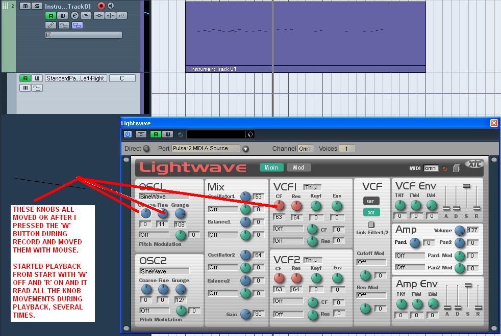

Well it seems to be working on mine, some of the Scope devices dont load - LightWave 5 gives an error, so this is just normal LightWave.
LightWave XTC Automated
Ive got one automation track and its recorded the movement of 3 knobs on the lightwave.

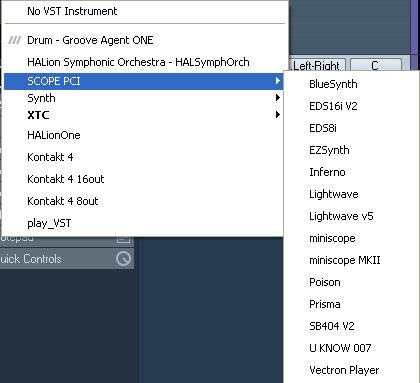

Also not sure why Ive got Scope-PCI as well as XTC synths on the menu - aren't they the same thing ?
xtc-and-scope-pci-synths

Ok will test poison and prisma tomorrow .. On crappy iPhone at the mo. I don't have XITE but I think the cubase plugin scanner picked up my old Scope 4.0 folder in C drive and called that XTC so I will use the synths under Scope-PCI menu.
