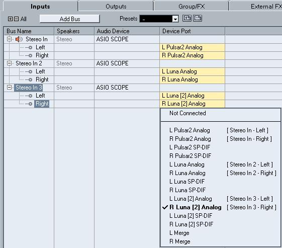

SOLVED! Help! Cubase 5.5.1 and scope 4 asio problem
Posted: Tue Sep 07, 2010 8:28 am
by djstudio
hi, i have solved :-)
I remember once I had the same problem that i had solved as in image:
