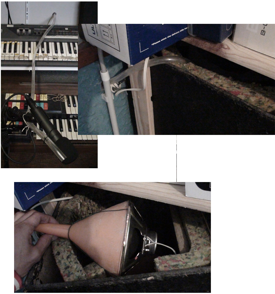

Dry sound to the speaker, through funnel and tube. Then mouth reflects 'formant filtered' sound back to mike, which is then monitored/recorded. Effect is like a light vowelish auto-wah.
Had good fun with other 'echo chambers', too: Another funnel, coffee pot, my daughter's little plastic shovel, etc =] The effect when sliding the chambers over and away from the tube exit/mike combo is more phasing/flanging, comparable to the sound of your footsteps when you're walking through an alley.
I first had the talkbox sitting next to me, but the direct speaker sound mixed in the mike, too much. So I used the spare hole in the wall ;) to put the talkbox in the next room, a small storage room where my DAW is, too. That did away with the talkbox mess, and with the crossbleed.
3eu talkbox: had to buy old speaker to canibalize.  Using old spare amp, household funnel and left-over tube from construction works.
