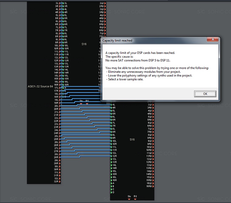

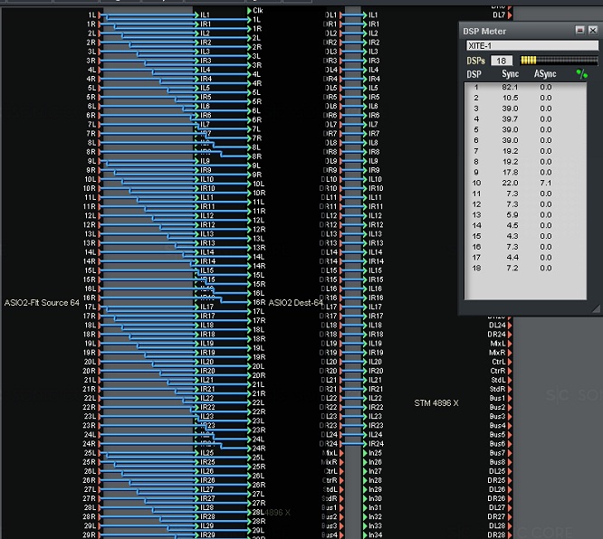

Don't take this the wrong way but I have a few questions.
When you install new DSP files over the old ones, are you taking the time to use Select All / Copy / Paste of the old files, than paste over the new files and say No about 3 hundred times..?
Also does this problem occur when using the STM4896..?
I have noticed new behavior when using the STM4896. I can max out all connections and ASIO I/O's, but when I load a second STM4896 it doesn't show me a window or any sign of trouble. It just won't allow me to make further connections..........??
Perhaps I will go back to 14.
17 is where my ASIO issues appeared.
19 seems to allow much more, but I used 14 live for a long time and it works perfectly well for my needs.
Try the 2 x STM4896 mixers and tell me what you get.
Spasibo.
JV
Below I have no windows or warnings and I am strangely locked out from making further connections..............zero.
These kind of inconsistencies make me leary of using it live.
I am going to try and see what the fix list was for this unnannounced release.
It sure would help as I don't really have time to BETA test every detail.
Spasibo.
JV

1 no.
I do a clean install.
2 with STM 4896 no problem.
3 about "impossible" connect - I've seen this error before, connect IS enable, but only "manual select" in scope sidebar, usually after a reboot everything works well, but I could be wrong, can not remember exactly..
4 2STM 4896 seems to work...

For this, first try assigning the S16's to another DSP like 14, and then try hooking up the rest of the ASIO I/O's.tjsound wrote:for asio nothing changed...
Afterwards manually clear the DSP assignments on the S16.

Again, Ralf has mentioned that the 4896's are already optimized for DSP usage. It's the 3rd party devices such as the spacef modulars that are not automatically optimizing for DSP distribution (yet).
