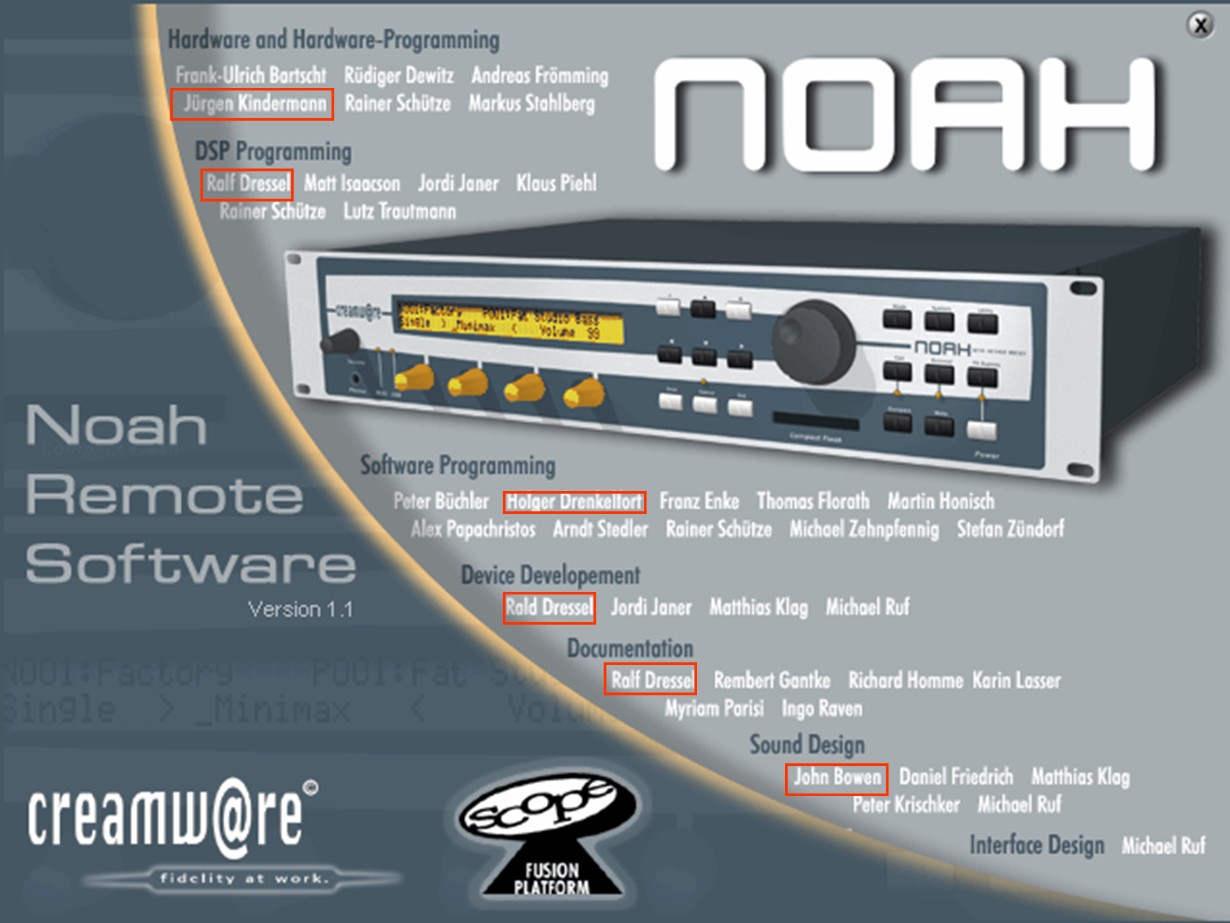

				Just noticed tonight where I already saw Ralf Dressel name ...
- Noah about.jpg (148.43 KiB) Viewed 23501 times
If you make the same check with a Scope 5.0.2617 About box you will notice that most of the name are also on the Scope 5 about box.
