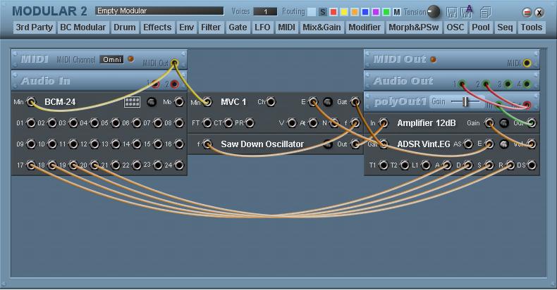

Spotted BC Modular in the devices section and given that I've just bought a shiny new BCR2000 I thought I'd give it a go.
I've pushed the sysex file included up to my BCR and built a basic test patch and I seem to be hitting a problem when attempting to change parameter values either using the control panel i.e. BCM-24 or my hardware controller - as soon as I touch the controller the parameter jumps to its max value.
For example I have linked output 17 on the BCM to my Env At value - if I open the ADSR panel and look at the attack slider it instantly jumps from 0.1ms to something like 352283ms as soon as I touch the rotary control?
I know I'm doing something stupid but I can't figure out what.
I'd also appreciate a heads up on how to use the ABS14 mode supported by the BCR/BCM setup. I've tried changing a rotary control to ABS14 and inserting an ABS14 module but cant seem to get any output.
