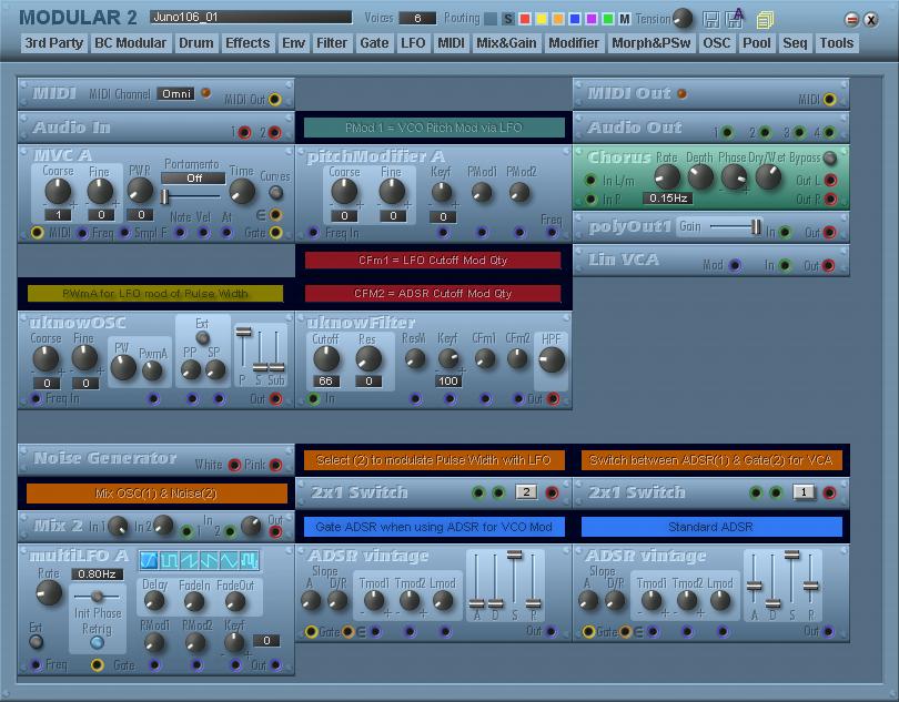

				OK -slightly duff info there.
I am creating a new preset file for my patch.  I create a bank and then a couple of presets and store the file.
If I select one of the presets then some parameters change correctly however some dont! On my Juno patch for example the PW on the UKNOW OSC changes correctly but the CF of the filter doesn't and neither does my ADSR....go figure..
What am I doing wrong here as it must be me doing something stupid - it's driving me nuts however.

				Re: Modular preset
				Posted: Tue May 25, 2010 3:53 pm
				Cables would help..........

				Thanks for the replies guys.
I've located the problem and it relates to assigning CC to parameters - if I remove my CC settings then the patch updates and sounds fine - if I add them again then modular misbehaves.
Anyone be able to confirm that this is not just me?
Assign some CC's to a vintage ADSR and save a couple of presets with different envelopes. Select them and let me know what happens - in my patch the ADSR settings change visually but the env sound is just the same...if I touch one of the env parameters the output changes to the correct env sound. If I remove the CC's then loading a preset works fine.
Si
				Re: Modular preset
				Posted: Wed May 26, 2010 2:35 pm
				by roy thinnes
				confirmed, same here.
possible workaround: save your controler settings in the Midi controler preset list, and save another Midi controler preset with all CCs removed.
in this mode all presets work; if you want to use CCs again, just switch to your first CC preset again.
